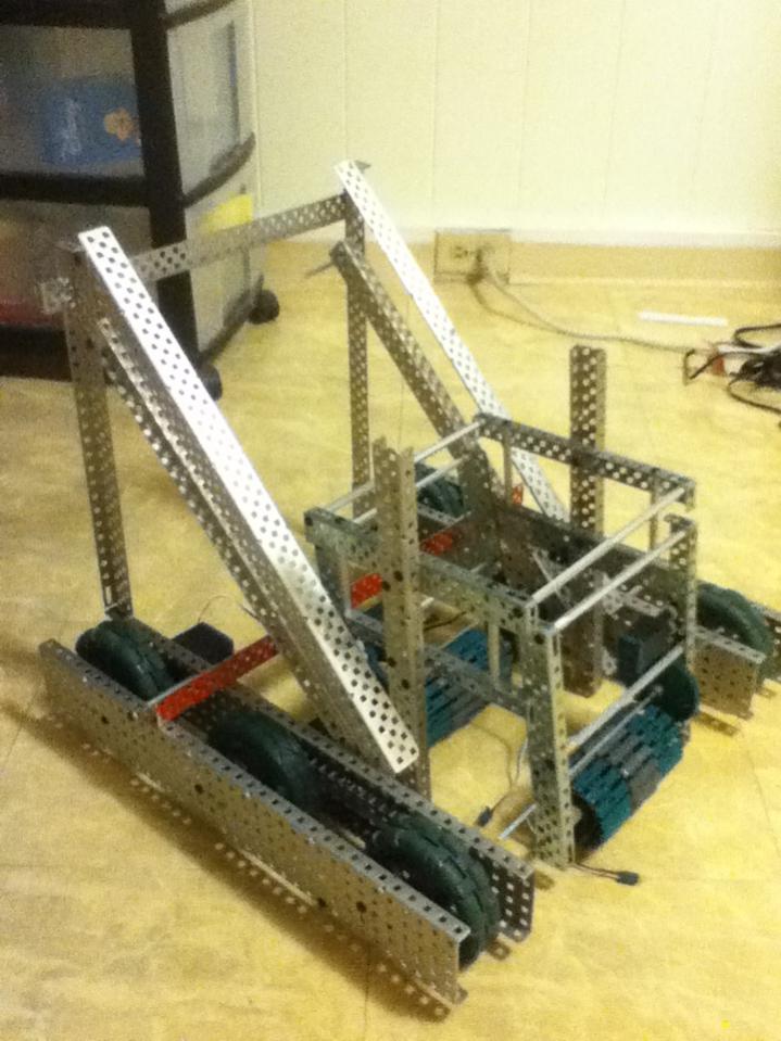

To be honest we didn’t have the game pieces yet so we improvised with plastic mayo jars without the label (the jar was slick). We ran two tests with the intake, the first with the jars as is, the second with the jars filled to about half a pound.
The intake was able to suck up the jars in any orientation, upright, on its side, rolling away (to some extent), and diagonal to the front plane of the intake. It was also able to consistently do this with jars already loaded above it.
For the intake I used a total of 6 15t tank tread sprockets in this order (there we two rollers in the whole intake and just copies of the other)
1st sprocket: sprocket wrapped in 15 green tank tread links
2nd sprocket: sprocket wrapped in 15 high friction rubber tread pad links
3rd sprocket: sprocket wrapped in 15 green tank tread links
I would totally use it in competition, except I’m obsessed with the 8 motor drive so I’m sticking to pneumatics. Our G team will most likely be using the intake.
The attached image below is 3008A first prototype. I think our G team will be using something like it. Just wondering, how many members does your team have?
Me and my Brother just came up with and CAD’d one of these earlier today. How do you think this would work without the high friction rubber treads (we don’t have any), but with cable ties attached to the tracks instead (like most elevation bots had)?
Also, I think I’m missing something really obvious here, but what is being gained by having multiple “intake rollers” (ie. more than one gear) on each side?
  • but with cable ties attached to the tracks instead (like most elevation bots had)?*
You mean the zipties? Hmm, i didnt try it with zip ties, but i think if you use them, perhaps cutting them to half length they would play the ball toward the intake and as long as you could lower the intake it should be able to suck it in. Using just the green treads should work as well as long as you can keep some tension.
However, something that you could definitely do that I’m pretty confident will work is wrap the treads with rubber bands or the vex latex tubing.
Do you mean the actual gears (like the 60t and 12t connecting to the motor?) If you are talking about those I used those just so i could position the motor inside the intake so it didn’t get in the way of the 4bar linkage. If you position it on the outside its just asking to get hit and doesn’t look symmetrical.
Now if your asking why i have six rollers total, I’ve actually never tried it with just one roller, but the purpose of having so many rollers was to keep the barrels on its side while inside the intake. That way it doesn’t get jumbled up. Another reason would be because if I’m sucking game pieces I wouldn’t have to rely solely on the single roller but the other rollers to guide it in. It provides more surface area to make contact with the game pieces.
Probably the most important reason is because it keeps the long shaft rigid. By putting only a single roller in the center I would have around 2 inches at least on both ends to bend or pop out of the bearings.

On the intake there are two 3 wire motors. I tried linking the whole intake onto one motor, but thats making things too complicated and messy. The motors are geared 1:1. Its set up like this
(Motor)12t-60t-12t(roller)
You will probably also see teams using the black rollers for their intakes. That was the very first material i tried out for the intake and it sucks. When geared at 1:1 the larger bore roller intake that i showed a picture of is much much better (a lot faster). I wouldn’t worry much about torque.
