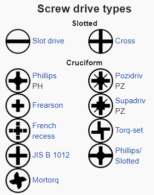

Some problems come up because not every plus shaped hole is actually Phillips. Specifically, JIS has a different internal shape, and a driver for one will turn the other, but may strip each other out worse.

#11
Oh, certainly. My advice was only for phillips. Typically with small phillips sizes you’re better off with a sharp (not sure that’s the best word) larger size screwdriver than the screw is expected to use because it will grab more of the screw head and so be less likely to strip the screw. I wasn’t suggesting using phillips screwdrivers for non-phillips screwdriver purposes.
