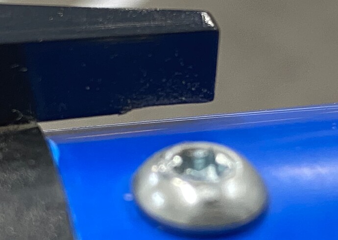

My team is assembling the Spin Up field and the screws on the rollers hit the prongs that tell you which side is up. Is it supposed to do this or is something wrong?
At Vex Worlds I got to go up close to the field they had and a Head Ref showed me how they worked and they intentionally do that as a way to kind of lock it in one of the two states.

Yikes, I can see those prongs breaking off/wearing down with repeated use as the screw contacts the prong over, and over again. Hopefully this doesn’t evolve into a problem later in the season.

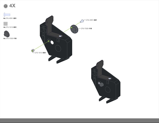

There was discussion about this at the EP Summit. When assembling the rollers there is a rubber disk that is used to slow the spin. It should be just tight enough that you can’t flick spin the disk with a finger.
Problem is people (like me) that tighten everything on a field to make sure it never comes apart. This means the rubber disk is compressed and becomes wider. This means more surface contact with the roller and makes it much harder for a robot to move it.

Do you have a source on that? Build instructions don’t say anything about how much to tighten that screw:
I’m curious how much of an effect the tightness of that screw has on roller resistance vs. other factors (such as wear over time). I guess the idea is that with the screw tighter, the rubber nub deflects more towards the gear, thus pushing into it harder?
Looks like those screws ought to be accessible when the roller is fully assembled, maybe I’ll play around with our field next week and see how much of a difference it makes.
Yep, it deforms it and pushes harder on the roller.
There was no printed / written guidelines. There was a field set up at the EP summit. I spun their rollers and they moved pretty easy but were “sticky”. I asked what the deal was between mine that spin with much force vs the ones there. That was the explanation I got. I’ll incant @VEX_GDC and maybe they can add something in the next manual update.

Our coach shaved down all of the prongs because he thought that it was a problem with the manufacturing. Guess not.

So I understand that the screws hitting is intentionally, however, our field is already showing signs of damage.
This after less than 2 months of use from 1 robot. Each of the rollers has probably only been spun a couple hundred of times. This might seem like a lot, but a roller could be spun thousands of times of the course of a season. I can only imagine how much worse this will after multiple tournaments and months of practice from multiple robots.
I am concerned about these parts getting more worn down and causing a huge amount of inconsistency. I wouldn’t be shocked if the screws didn’t hit at all by worlds due to continued use.
