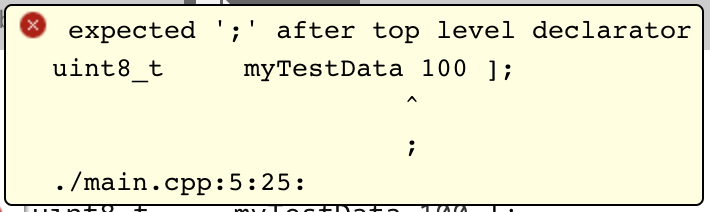

After running this same exact code I got a couple errors I think all starting from this one at the uint8_t part
07%20PM
That’s strange, wonder how/why those [ were removed. I will fix the original code.
thanks that fixed that but that myTestData* = i * 2; does not work anymore it gives the error: expected expression myTestData* I * 2, which is the same thing weirdly enough
that I don’t know what to do from here for that I think its the whole unsigned char thing
I get the feeling that code was corrupted somehow, perhaps in the forum migration, I’ll put another version later that works.
Here, this is what it should be

somehow text for arrays was messed up. So code like this myReadBuffer* should be myReadBuffer[ i ]
I suspect that a migration script mistakenly took [ i ] as an italic tag or something like that.
Thanks that worked. I guess that was the only problem
