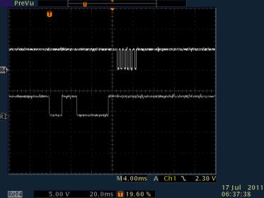

Not sure what you are after exactly but I can tell you what I know of how the PC software achieves this using the VEX programming cable. This would be for a serial connection from PC to Joystick. I have not looked at USB connection direct to Cortex much yet, it uses similar messages to the serial communication for many things but in this area I assume it would be different.
To toggle Robot Enable/Disable or Autonomous/Driver control, the following sequence is used.
  1. Change serial baud rate to 9600.
  2. Set RTS
  3. Wait 5mS
  4. Clear RTS
  5. Wait 15mS
  6. Set RTS
  7. Wait 10mS
  8. Send serial char 0x35 to toggle enable/disable or
    Send 0x22 to toggle Autonomous/Driver control
  9. Wait 20mS
  10. Clear RTS
  11. Wait perhaps 250mS, you can get some feedback on CTS I think but its just easier to have a delay.
  12. change baud back to normal and continue communications.
This communication does not go through the programming cable to the Joystick but is intercepted by a PIC inside the programming adapter.
The PIC decodes the 0x35 (or 0x22) character and creates a pulse train on the RTS line going to the Joystick. 8 pulses, each of 3.3mS with a 50% duty cycle (that is 1.65mS low, 1.65mS high) are sent for the Enable/Disable command. 6 pulses with the same specs are sent for the Autonomous/Driver command. Pushing the button on the programming adapter sends 5 pulses.
Here’s a waveform showing RTS in (lower trace) to RTS out (upper trace) on the programming cable for the autonomous command.
https://vexforum.com/attachment.php?attachmentid=4417&stc=1&d=1311735105
I’ve no idea why it has to be this complex but can only assume it’s for some type of backwards compatibility with the older PIC 0.5.
Hope this was not confidential but engineers are curious people, we always want to know how things work :slight_smile:
