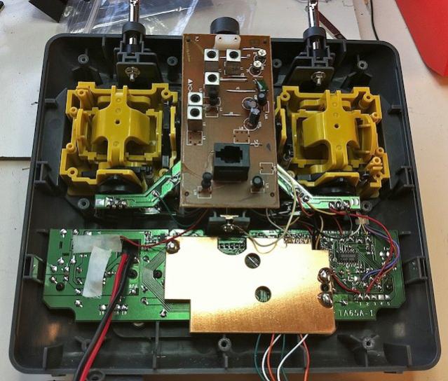

Here are some pictures that will help show what you need to modify.
First, you need to open the transmitter. To do this, unplug the crystal (if present), then remove the battery cover (and battery, if present). Then remove the nine phillips-head screws that hold the back cover in place. The back cover has wires going to the battery compartment, so when you open the case, treat it like it has a hinge at the bottom. You should see something like this:
[ATTACH]3433[/ATTACH]
You’ll notice the rectangular brownish board in the middle. This is the modulator/transmitter board. Carefully lift this board off of its posts and turn it over.

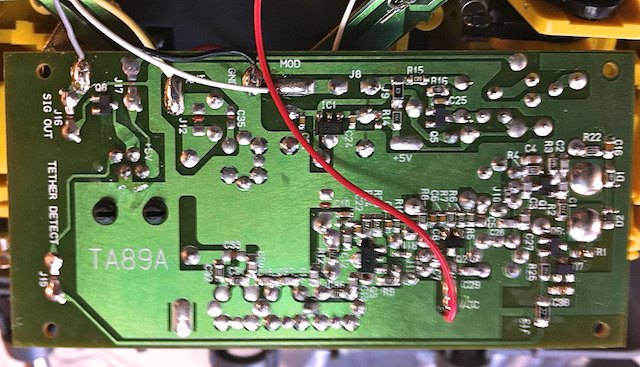

[ATTACH]3436[/ATTACH]
You can see there are 5 wires going to solder points on the back of the board. These points are even labeled:
[INDENT]
[LIST]
*]GND (Black) Ground for signals and power
*]VCC (Red) Battery power, +9V typical
*]ANT (Yellow) Antenna output
*]MOD (White) Modulator input
*]SIG (Gray) Tether input
[/LIST]
[/INDENT]
To transmit a control signal that you generate, you would cut the White wire (MODulator input) and feed your signal there. Your signal should be an Open Collector output without a pull-up resistor. The transmitter will pull this up to about 2V, so this should be compatible with 5V or 3.3V logic.
If you want to get fancy, you could mount a switching jack like this one, which will pass the internal signal if nothing is plugged in, or use the external signal if something is plugged in.
The signal you generate will be a positive PPM signal, meaning that this signal is at low most of the time, but with brief high pulses. The 7-puse train will need to be repeated about 54 times per second.
Don’t forget, the ground of your microcontroller needs to share a common ground with this board. Just solder a ground wire between the Black (GND) signal on this board to a ground contact on your microcontroller.

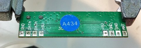

I’ve just posted a pair of diagrams that show how to wire the receiver module and transmitter modules to a Vex. They can be found here.
Since you will be hooking the transmitter to your PIC board, you’ll have to handle that wiring yourself, but it is extremely straightforward. There are only four pins and they are well labeled.
When I wired my receiver module up, I noticed that the pins on the module were just wires soldered to pads on the module. To make the whole assembly more compact, I decided to remove these pins and solder the wires directly to the PCB.
So I carefully unsoldered the pins and cleaned the pads with some solder wick:

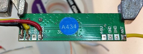

[ATTACH]3571[/ATTACH]
Then I soldered the wires as shown in the drawings:
[ATTACH]3574[/ATTACH]

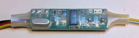

And then covered it all up with some clear heat-shrink tubing:
[ATTACH]3577[/ATTACH]
Here is the whole module ready to plug into the RX port:
