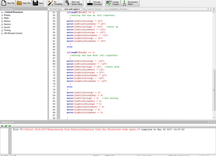

I couldn’t respond to my last conversation, however i am still having issues regarding my code, which will not run the lift portion on my robot once it is downloaded, I was wondering if anyone knew whats up, and if it might be an issue with my code of with the remote it self
I have the code running to move my lift using button 6, yet when ever I download the code to the robot, nothing will move using any on the buttons (other than the joysticks which run my chassis). I have tried all of the following in order to try and troubleshoot, yet nothing seems to work:

below is an attachment of what this section of my code looks like
I’m guessing that you only have four motors on your lift, in the code you are setting eight motors. You need to have it setting just four motors going all in the same direction for each “if” loop. Also just have four motors in the motor and sensor setup, not one for each direction.

A, are the if statements contained within a while loop? They need to be. B, if you have already done that, try deleting the else on line 63. C, if that doesn’t fix it, try changing the else on line 77 to (idk if this is the correct function) elif((vexRT[Btn6U] == 0) && (vexRT[Btn6D] == 0))
Is it in a while(true)?

Here is the copy of my code, right now we have out lift with 8 motors but I’m working on a solution with one of my builders to be able to bring it down to 4 motors

The immediate problem I see is that you close your while loop before your if statements that control the motors. The program is stuck looping on just your joystick controls. All you have to do to fix this is move the if statements into the same while loops as the drive motor controls.
So do I create an extra while statement before the if statements that control the motors, or do i just extend the one that is already there?
Thank you all, i got it to work :slight_smile:
