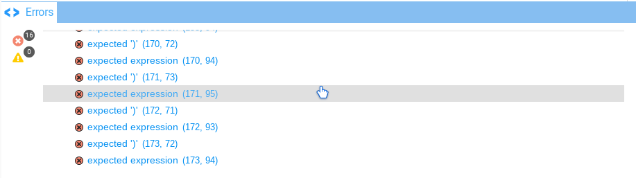

Self- aligning mechanum wheel code help
I think I have my self aligning code figured out mathematically (unable to test atm), but I keep getting errors in building

CODE WITH ERRORS
void straight(double d, int fastness){
    XAxisEncoder.setPosition(0, degrees);
    ZAxisEncoder.setPosition(0, degrees);
    Inertial1.setHeading(180, degrees);
    DrivetrainSpeed(fastness);
    FrontLeft.spin(vex::directionType::fwd, (fastness * ((180-(inertial.heading(degrees)-180))/180))+XAxisEncoder.position(degrees),  vex::velocityUnits::pct);
    FrontRight.spin(vex::directionType::fwd, (fastness * ((180+(inertial.heading(degrees)-180))/180))-XAxisEncoder.position(degrees), vex::velocityUnits::pct);
    RearLeft.spin(vex::directionType::fwd, (fastness * ((180-(inertial.heading(degrees)-180))/180))-XAxisEncoder.position(degrees), vex::velocityUnits::pct);
    RearRight.spin(vex::directionType::fwd, (fastness * ((180+(inertial.heading(degrees)-180))/180))+XAxisEncoder.position(degrees), vex::velocityUnits::pct);
    while (!(ZAxisEncoder.position(turns) == d/12.56637)){
      wait(1,msec);
      break;

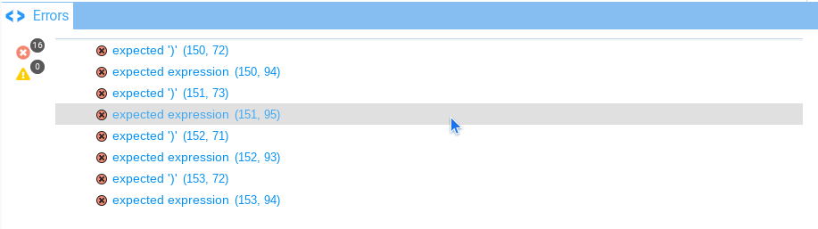

SCREENSHOTS
Screenshot 2021-03-29 10.30.57
Screenshot 2021-03-29 10.31.11
well the first thing is you probably want to do calculations inside the functions instead of calculating everything when the program starts.
Also you really should use at the very least a P loop. Just stopping the drive base instantly when you reach the target will cause massive slip.
Can you explain what you mean by p loop?
And I thought I was calculating it inside the function
P loop scales down the power supplied to the motors with the distance from you to the target position
and it looks like those are calculated globally.
Can you give an example of calculating inside the function?
So it’s like a linear function based off distance to target?
yes. you just have a constant kP and the Error, which is the difference between the target and the position. you multiply kP by the Error to get the power. this should take the form of a while loop that breaks out when you reach the target. There are more advanced and faster things like PID, but P is more enough for starting.
velocity=(error/intended distance)*100?
no.
velocity = error * kP
error = intended - current
Is kP a known value?
Sorry its taking me a bit, this is my first coding project.
kp is a constant you need to figure out.
I see

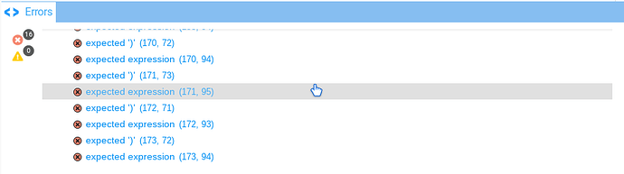

Is there anyone who knows how to get the errors to just go away so I can test?
I will try and learn the p loop stuff if it does not work
Fixed, the issue was simple capitalization and naming errors.

    FrontLeft.spin(vex::directionType::fwd, (fastness * ((180-(Inertial1.heading(degrees)-180))/180))+XAxisEncoder.position(degrees),  vex::velocityUnits::pct);
    FrontRight.spin(vex::directionType::fwd, (fastness * ((180+(Inertial1.heading(degrees)-180))/180))-XAxisEncoder.position(degrees), vex::velocityUnits::pct);
    RearLeft.spin(vex::directionType::fwd, (fastness * ((180-(Inertial1.heading(degrees)-180))/180))-XAxisEncoder.position(degrees), vex::velocityUnits::pct);
    RearRight.spin(vex::directionType::fwd, (fastness * ((180+(Inertial1.heading(degrees)-180))/180))+XAxisEncoder.position(degrees), vex::velocityUnits::pct);
      wait(1,msec);
      break;
    FrontLeft.stop();
    FrontRight.stop();
    RearLeft.stop();
    RearRight.stop();
    DrivetrainSpeed(100);
void side(double d, int fastness){
    FrontLeft.spin(vex::directionType::fwd, (fastness * ((180-(Inertial1.heading(degrees)-180))/180))-ZAxisEncoder.position(degrees),  vex::velocityUnits::pct);
    FrontRight.spin(vex::directionType::rev, (fastness * ((180-(Inertial1.heading(degrees)-180))/180))-ZAxisEncoder.position(degrees), vex::velocityUnits::pct);
    RearLeft.spin(vex::directionType::rev, (fastness * ((180+(Inertial1.heading(degrees)-180))/180))-ZAxisEncoder.position(degrees), vex::velocityUnits::pct);
    RearRight.spin(vex::directionType::fwd, (fastness * ((180+(Inertial1.heading(degrees)-180))/180))-ZAxisEncoder.position(degrees), vex::velocityUnits::pct);
    while (!(XAxisEncoder.position(turns) == d/12.56637)){
      wait(1,msec);
      break;
    FrontLeft.stop();
    FrontRight.stop();
    RearLeft.stop();
    RearRight.stop();
