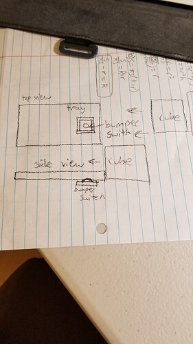

How would you position it so that the bumper switch doesn’t block the intake?
So for example, in a tray stacker I would put it in the middle of the intakes at the front so as it’s getting pulled up it would push the bumper.
But wouldn’t the bumper block the tray opening?
Or does the bumper move up with the cubes?
No, because it would be a bit below the track that the cubes move up.
So like, embedded in the tray?

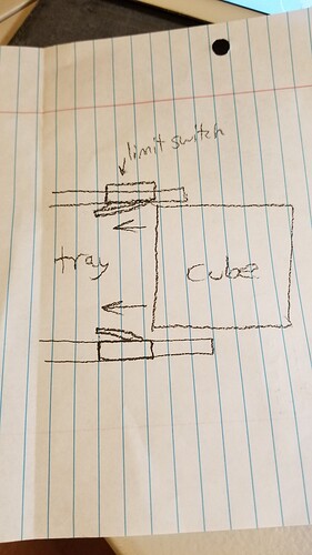

I was thinking along the lines of limit switches mounted on the sides like so

Actually I like your idea more than my original one. So that would be a revision on my part.
Well, take time to consider your own idea anyways, you never know!

It could be, if you recessed the bumper switch into the tray backing like so
20190904_165225
Ya I think it’s possible, but one of the problems would be if the sensor blocks the tray.
No, instead of a bumper switch I decided I liked railgunawesome’s idea better and am going to put limit switches in the side.
