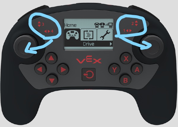

sure. I can’t find the controls for buttons 1 2 3 and 4. I see every other button though. What’s the problem?
The only buttons you can program are L1, L2, R1, R2, A, B, X, Y, Left, Up, Down, Right
unless you pull a big brain and use a different controller, doubt if thats allowed tho
what are the 1,2,3, and 4 buttons for though
U can use them for anything. U might be able to only use two buttons where pressing up puts u to the next highest tower and pressing down puts u to the next lowest tower
There are no 1,2,3,4 buttons?
On the controller, yes. In programming, no.
I dont think there are
There aren’t any buttons named 1, 2, 3, or 4. You might be referring to the joystick axes 1, 2, 3, and 4.
Inkedfile-rBiN9q09fh_LI
Axis 1 is the horizontal axis of the right joystick, axis 2 is the vertical axis of the right joystick, axis 3 is the vertical axis of the left joystick, and axis 4 is the horizontal axis of the left joystick
those are for the base usually i think
sorry meant up down left right…wait oops it’s actually in the program
