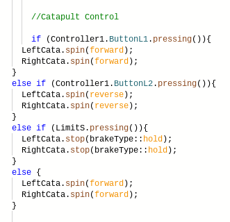

This is my catapult code
Screenshot 2024-02-14 7.28.30 PM

Ah, only used Python for stats stuff so I’m not used to seeing Vex objects. If this code is in the main driver control while loop, this isn’t a great way to do this (assuming the while loop is purely to block the code until the cata is pulled back all the way). It should work though.
I think a modified version of this would work for my cata code but we dont have a ratchet and we need it to spin to the limit switch at the begining of the code.
