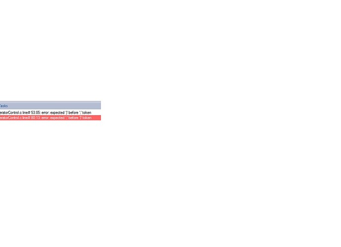

I’m working with SPOTBOTS on the robot, and we’ve gotten everything written that you had there, but it’s failing to compile with the error:

Thank u guys for all of your help and support i got it setup and i am just trying to convert it to digital because you had it setup to my lift :p. anyway thank you so much. i have a basic understanding of how it works, now because of guys.:smiley:
There was a typo on GetJoystickAnalog (you had getJoystickAnalog).
Glad you made progress. Understanding how the code is supposed to work is the most important thing, just typing it in and blindly hoping that it works doesn’t help you much, if you have more questions just post. You may also need to play with the proportional constant, I threw 0.3 in there but it may need adjusting, too big and the arm will oscillate, too small and the arm will not be able to get close to the target.
yeah it was oscillating, and i had my finger was on it and pinched the crap out of me. like i said i was converting it to digital and this is my error.i switched the GetJoystickAnalog with GetJoystickDigital. what would i need to do with that error?
You cannot just replace GetJoystickAnalog with GetJoystickDigital
The analog joystick returns a value in the range -127 to +127, GetJoystickDigital returns a value of 0 (not pressed) or 1 (pressed). If you want to use two buttons to raise or lower the arm then you would need code something like this.

Hey guys i have came a long way and i have only 2 errors out of 91 lines of c code and i can not figure it out.
Either misplaced ā€œ;ā€ or ā€œ)ā€ or ā€œ}ā€
Cur and paste the EasyC code so I can see it.
