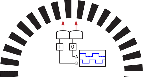

An example of a digital sensor is a quadrature encoder:
While the signal is digital, there is more data underlying that signal.
I believe encoders report in degree units.
Another example of a digital sensor is the ultrasonic sensor. In this case, one digital wire is used for sending the ultrasonic signal pulse, and the other is for receiving that pulse. The code (VEXos in this case) then has to calculate the delay between the two wires and figure out the distance. I don’t have the ultrasonic units off the top of my head, though I think it might be cm.
