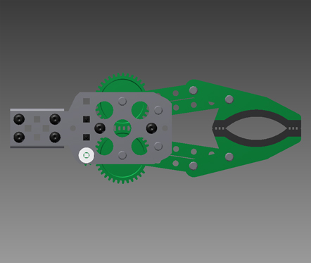

Can anyone think of any way of attaching a pot to the claw itself, to work out how much it is opened by, or maybe using the limiter switches for a similar job.

To mount the potentiometer I got a longer axle and mounted the potentiometer to the bottom of the claw.

Thanks, very informative. is the pot on the same axel as the motor, I was worried how much the motor needed to rotate to open and close the claw as its on a smaller gear?

Is about an 8 tooth change on the gear. The driving gear is a 12 tooth gear so about 240 deg of rotation is needed, just within the range of the pot.

Yes same axle, as James points out there is enough rotational motion on a Potentiometer ~270 deg so it provides useful information throughout the open close cycle ~240 deg. Mine could be better positioned, but as I don’t use it all that much it’s been o.k.
