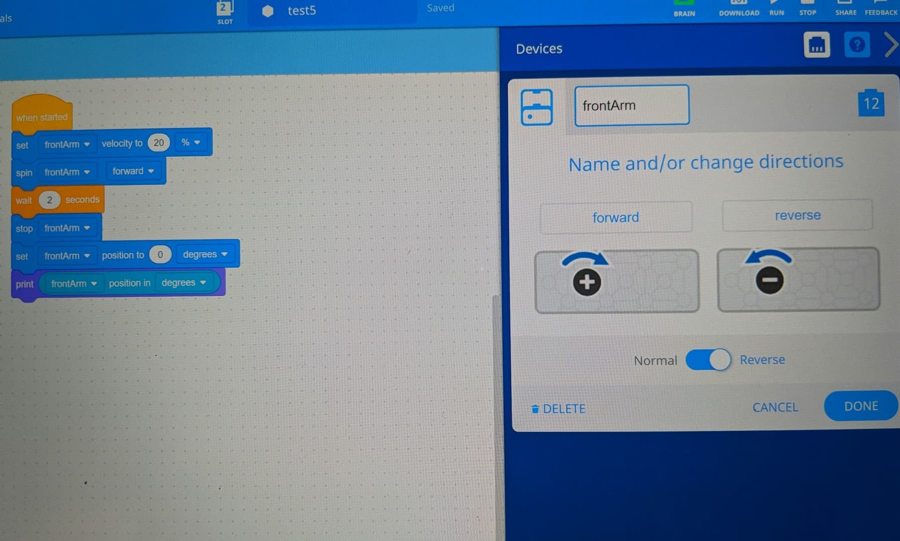

We noticed the same issue – it only seems to apply to motors that are reversed. See this simple test program
72160693_835118856948429_1173756889175949312_n
you would expect for it to print 0, but it does not.
Per this thread:
We identified the bug in question and will have it fixed for the next release in a few weeks.
