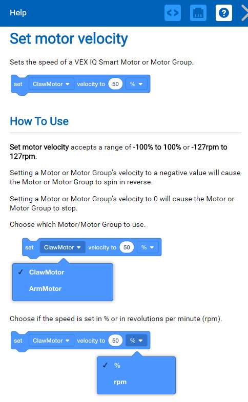

Here is the help menu:
Interesting – that’s not the behavior I would have expected from looking at the blocks or reading the help text.
Intuitively, I would expect a block that reads “set motor velocity to 50%” to set the velocity to 50% of the maximum velocity, rather than 50% power – that is, I would expect “set motor velocity to 50%” to do the same thing as “set motor velocity to 63.5 rpm”. But it sounds like that’s not the case – good to know that you can control the motor power directly!
