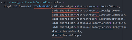

Our team just started using Okapi today and we’re having difficulty on setting up an x drive

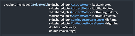

This is the documentation for an x-drive in okapi that I found at this link: okapi::XDriveModel class | OkapiLib A PROS library for programming VEX robots
I’m sure it’s not supposed to work if I just copy and paste it, but I’m not sure what to change.

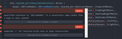

This is one of the errors that I get and I’m not sure what to do about it.

Hey there!
std::shared_ptr<ChassisController> chassis =
ChassisControllerBuilder()
    .withMotors(
        1,  // Top left
        -2, // Top right (reversed)
        -3, // Bottom right (reversed)
        4   // Bottom left
        // Green gearset, 4 in wheel diam, 11.5 in wheel track
    .withDimensions(AbstractMotor::gearset::green, {{4_in, 11.5_in}, imev5GreenTPR})
    .build();
Try this out. Make sure to replace the motor ports and the dimensions!

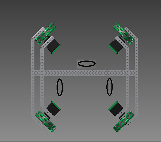

I believe you will need three encoders mounted on your drive thusly;
And then add a snippet to your chassis code with the encoder ports like this;
    .withSensors(
        ADIEncoder{'A', 'B'}, // left encoder in ADI ports A & B
        ADIEncoder{'C', 'D', true},  // right encoder in ADI ports C & D (reversed)
        ADIEncoder{'E', 'F'}  // middle encoder in ADI ports E & F
