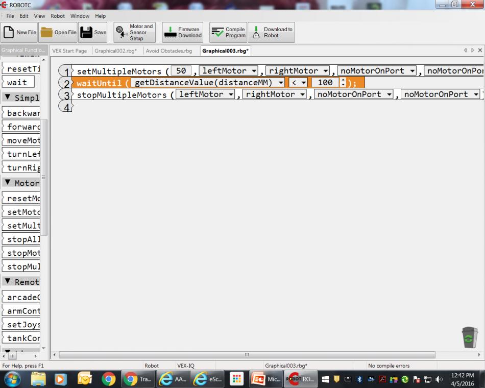

This is what I am trying to do. Move Forward until distance then stop
That suggests you’re using the ultrasonic distance sensor, are you?
It confuses me a bit, since you initially mentioned replacing the “forward” command.
If all you want to do is to blindly move 100mm, then the program would use no distance sensor and rely solely on the motor encoders. It would then read something like:
setMultipleMotors(50, leftMotor, rightMotor, , );
waitUntil(getMotorEncoder(leftMotor) >= 180);
stopMultipleMotors(leftMotor, rightMotor);
Now, why 180? I am assuming a lot: You’re using the usual 200mm travel size tires with no gears, directly attached to the motor. Thus one wheel rotation (360 degrees) would be 200mm travel size and for 100mm travel, you only need 180 degrees. I also assume that you’re using degrees as the motor encoder unit, which is the default.
If you really intended to use the ultrasonic distance sensor and keep running until the robot is 100mm from a wall, I would suggest using the firmware’s built-in Device Info screen to verify what does the distance sensor actually see in your setup, or possibly write a program displaying the current sensor reading while running, such as:
displaySensorValues(line1, distanceMM);
repeatUntil(getDistanceValue(distanceMM) < 100) {
    displaySensorValues(line2, distanceMM);
wait(100, seconds);
That way, you’d capture both the initial sensor reading (in case the loop never executed) and the continuous value while the robot is running.
