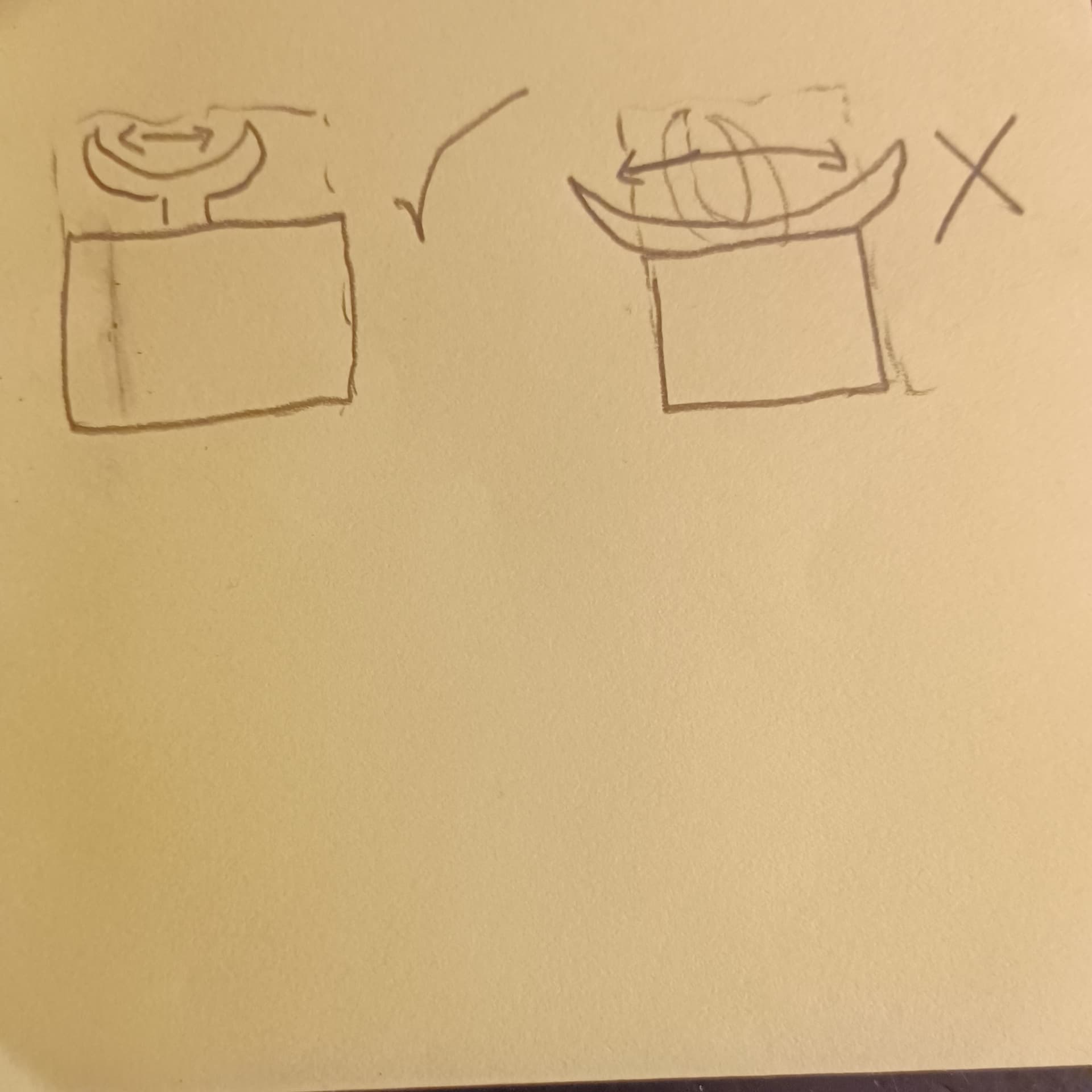

I have an expansion question and im not gonna make a new topic, but pretend you have a simple drive train with an arm, and a claw connected to the end of said arm. If you can only expand in one direction, then that should mean you can only use the arm and not the claw, right? cause the claw would be expanding in another direction than the arm.
This is from SG2-5
Say this legal, then at what point would it be considered a claw or expanding. If i put a claw that when opened would expand to the 18" limit, that’s obviously expanding, right?
An example might be the robot “Fever Dream” by 9MotorGang
Well, I assume your claw is not expanding past your original overall size (see diagram below).
If you’re talking about the one on the left, yes it is legal, since the claw isn’t horizontally expanding past the original overall dimension of the robot.
Even if the arm extends forward (in the y-direction), the claw’s x-expansion does not go beyond the robot’s overall x-width, so it isn’t a horizontal expansion in this case.
However, the one on the right obviously isn’t legal.
As long as you don’t expand beyond the starting width of your chassis, you would be legal.
Another fairly simple way to fix this is by simply having a ziptie poking out either side of the bot to make it 18 inches wide, which then expands your regime that you can work in slightly.

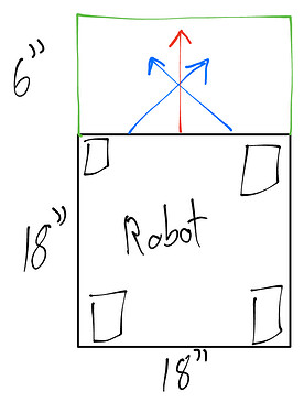

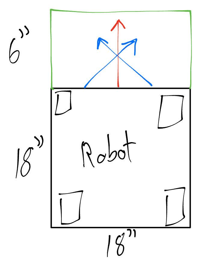

So, then would my rough sketch of a mechanism be legal.
The red arrow is the expansion side, and the blue arrows are my mechanism. As long as the blue lines don’t pass the green box, this is legal, right?
Yes, this would be legal.

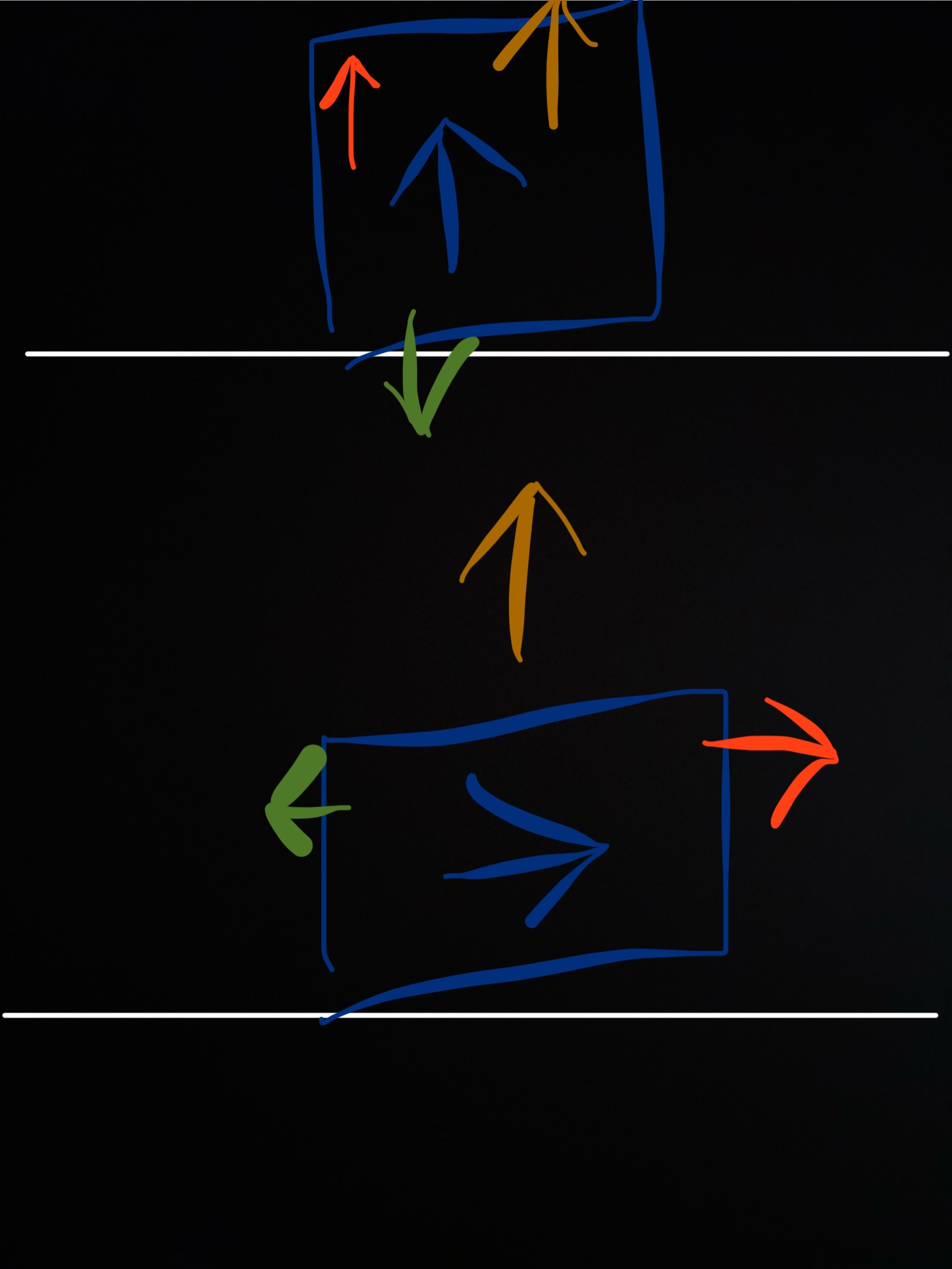

Your current idea will not be legal because if you look at sg2 and sg3 it says that vertical expansion is based off the field so always up no matter robot orientation. However for horizontal expansion it’s limited to the face of the robot no matter its orientation.
That was most likely already understood but in sg2 it states that if the face with the expansion was facing upwards it would be limited to the 6 inches not the vertical limit however if you changed the face so when you tip over is the back this would most likely be legal because it is not conflicting with the vertical expansion.
Here is an illustration:
The yellowish arrow indicates the vertical expansion
The orangey arrow indicates how you wanted to do this( not legal to expand past6 inches)
And the green arrow is another expansion face that you could use if you wanted to try this idea
Sorry if this didn’t make sense
