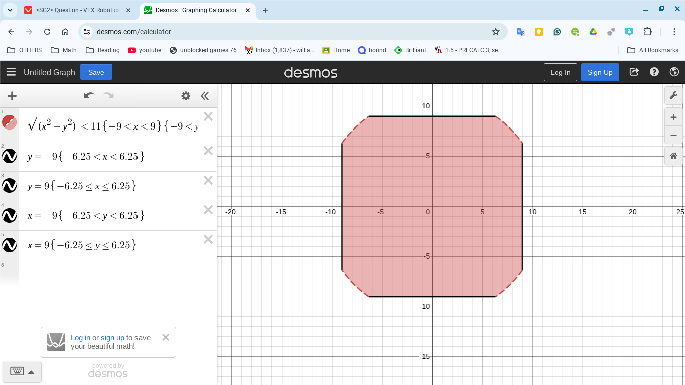

Fun thing to try out: go to Desmos and graph these 3 equations:
sqrt(x^2 + y^2) < 22
-18 < x < 18
-18 < y < 18
The area that’s covered by all three of these equations shows the legal starting configurations under the current rules!
Here is the correct equation: \sqrt{(x^{2}+y^{2})}<11\left{-9<x<9\right}\left{-9<y<9\right} (simple math error)
(The black lines are 12.5 or 25 hole lengths)

The limit isn’t 11 inches diagonal / 9 inches X & Y, it is double that (22in diagonal,18 in X, Y). What are the equations listed here trying to show?
I believe it mentions “relative to the playing Field” to clarify that it’s illegal if your robot intentionally rotates to an out-of-size position relative to the field (while still maintaining 22" diagonal when it’s the right side up).
Otherwise, you could build a robot that technically has a 22" diagonal when its in its starting position, but then intentionally slightly tip it forwards/backwards (which is out of size relative to the field) while still maintaining the 22" diagonal from the robot’s perspective.
I understand what you’re saying, but you’re confusing absolute and center distance. Your math implies, the starting size is 36x36 because the points (-18,0) and (18,0) are 36 units or inches apart. Then, for the diagonals, you’re confusing radius with the diameter, the formula for a circle is (x-h)^2+(y-k)^2=r^2; where the center is (h,k) and r is the radius or 1/2 diameter. Hope this helps :slight_smile:
