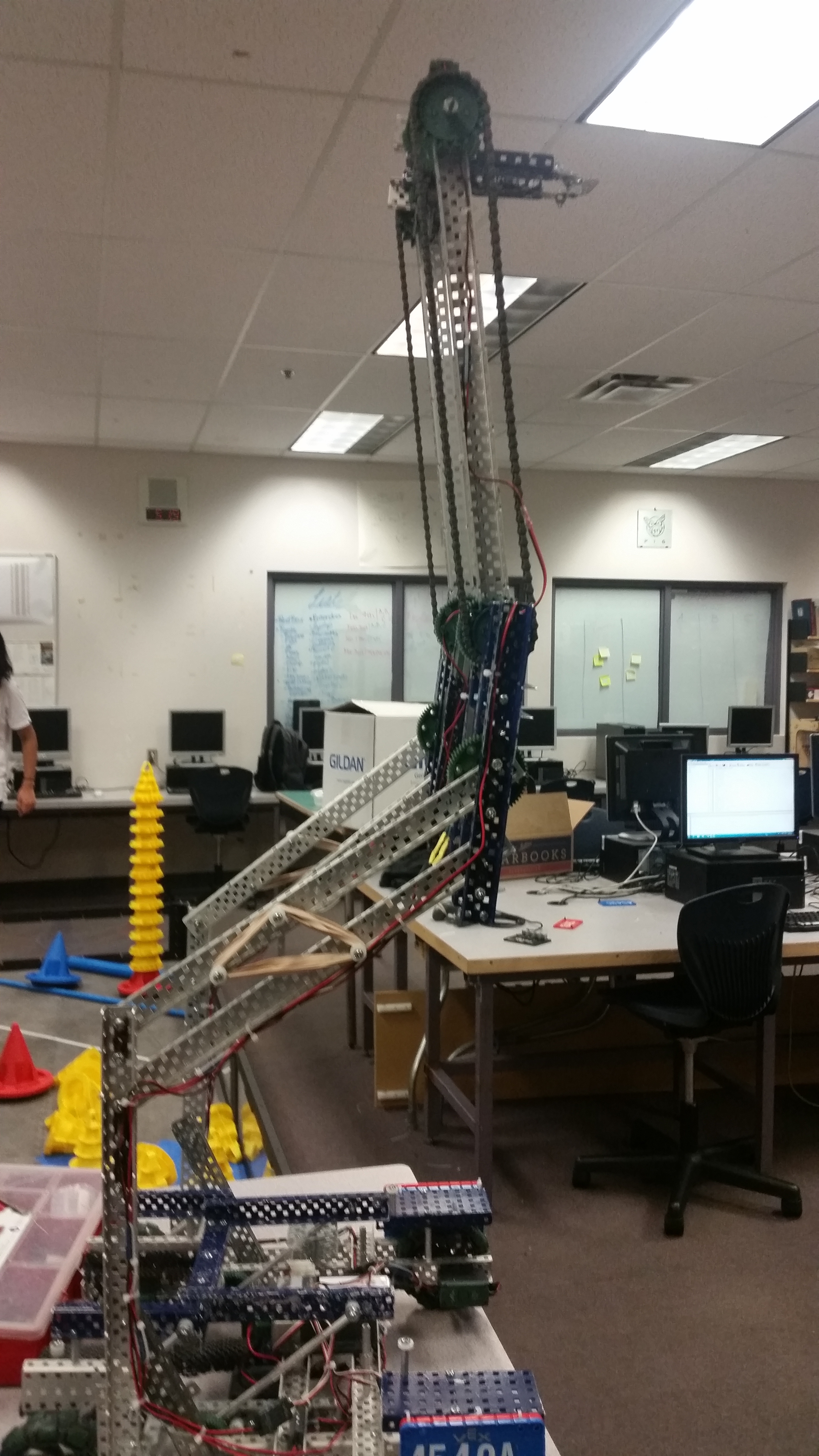

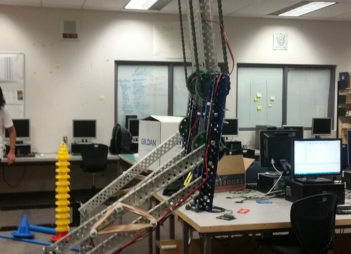

For the second option the thing is that we have our chainbar on top of a four bar so we dont have a full DR4B so it will be hard to put the sprockets
here is a pic
You can use the encoder similarly. It will work.

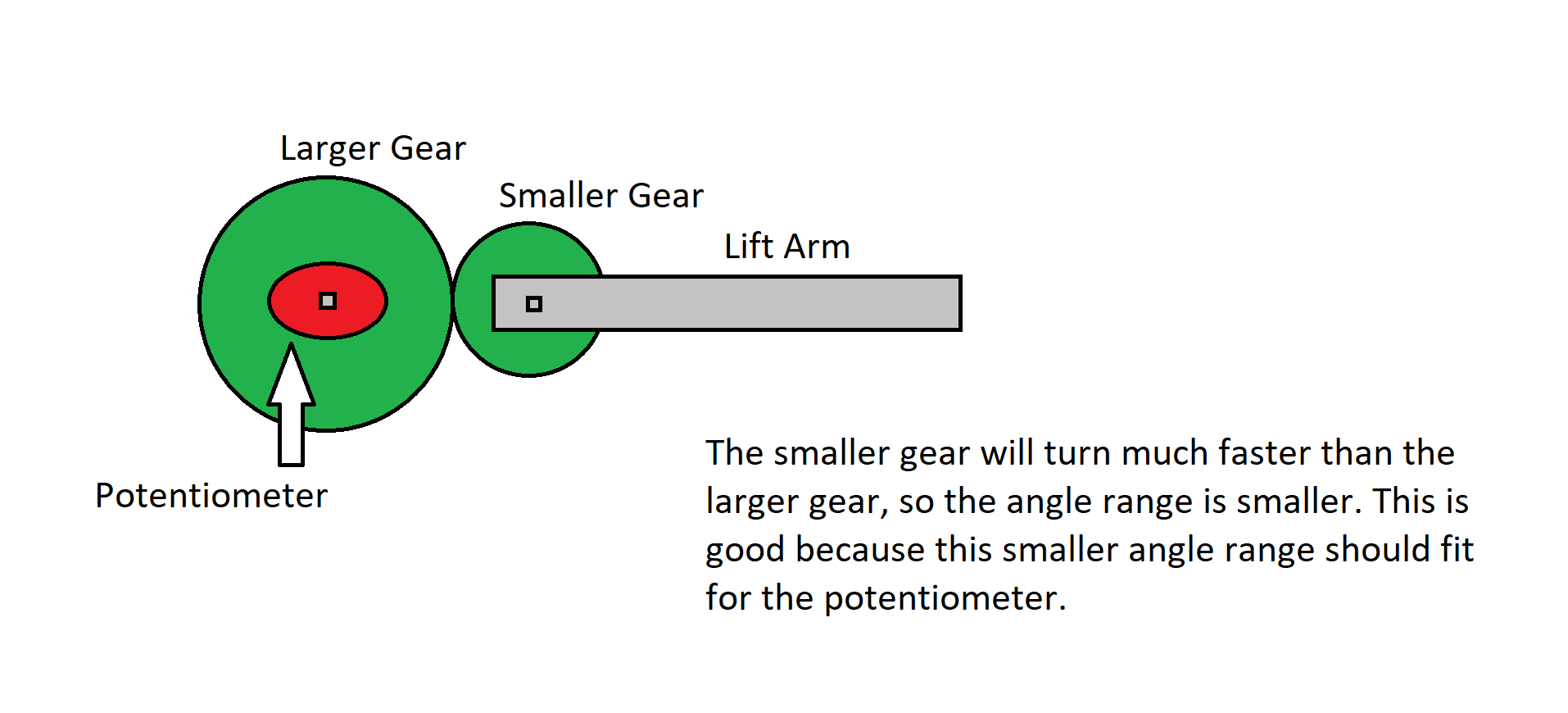

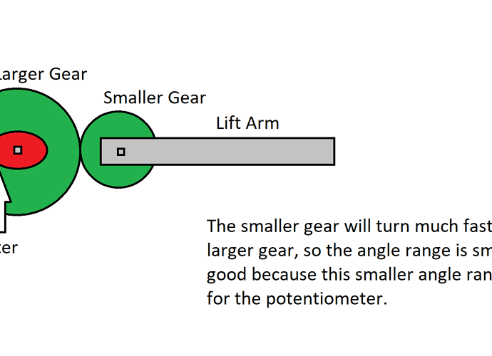

What he meant by this is to use a gear ratio to reduce the turn speed of the potentiometer.
You stated that your main problem was that the lift moved too far for your potentiometer to work in the range. To solve this, you could place a small gear on the lift axis and connect a larger one it through a gear chain. Let’s say that you use a 36-tooth gear for the lift and connect a 60-tooth gear to it. Then, mount the potentiometer to the axle with the 60-tooth gear (I will attach an image with an illustration).
Because of the small to large gear ratio, the potentiometer axle will turn at about half the speed of the lift, meaning that the angle range should be small enough to fit into the potentiometer.
I hope this helped. If you have any more questions, feel free to ask for clarification.
By the way, this principle applies to chain and sprockets as well as gears.
