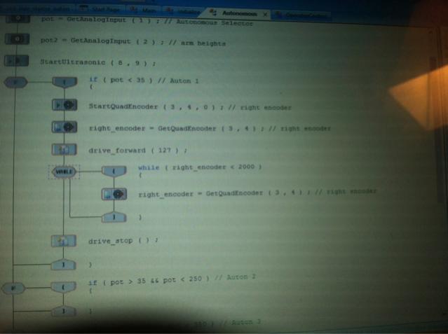

For as long as I’ve been in vex, I’ve done nearly all of our autonomous programming off timing alone. As I’m sure you all know, this tends to be extremely inconsistent. So I want to know how to have all of the “drive” parts of our code using shaft encoders. I have absolutely no idea where to start. We have an encoder on each side of the drive. We are using easy c v4. Any help is appreciated. Thanks

I haven’t used any of the smart blocks so I have no clue how waituntil works but this is how you can do it in easyC
startencoder blocks
get encoder set to variable named encoder
start motors
while loop (encoder<2000){
get encoder set to variable named encoder}
stop motors
Remember to update the variable every time the loop runs or you will only look at the encoder value back in the beginning.

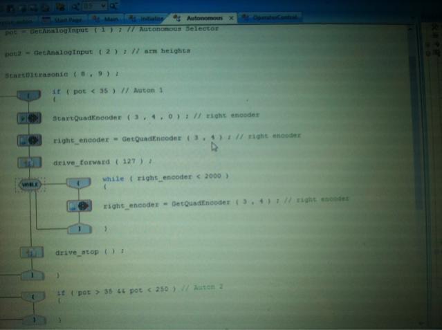

I just tried this, and it didn’t work. The wheels never stopped
This didn’t work
What happened? Could you send a screenshot of the code blocks because I don’t have easyC in front of me.
I’ve tried it a few different ways. [ATTACH]8987[/ATTACH][ATTACH]8988[/ATTACH] nothing seems to be working.
