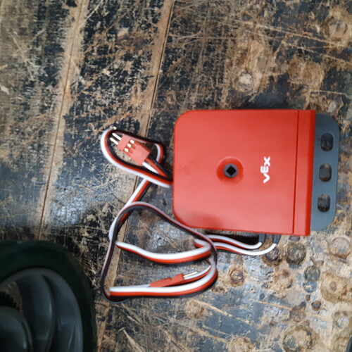

My problem as it sits is simple but complicated are school has a robotics class and are teacher was trying to work the quad coders or shafting coders. We were using the regular 393 model motors and as a brand new lesson never taught before accept to us now we are using these for are first time. The teacher was going to use them last year but there wasnt enough time. So we are all just as confused. We assumed the position is on the shaft similar to a 393 but the code is different since it uses revolutions instead of time but my teacher and even i cant seem to wrap are heads around it. So i came here to message for him since i know how to use forums as i frequent reddit
Picture Of Shafting Coder
shafting%20coder
Picture Of Base Code To Work Around Were Just As Lost As We Sound Here Seriously I Have No Idea If Were Even Close To Being On The Right Track

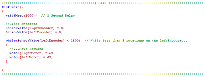

Some slow talking non-programmer made a set of videos 5 years ago that could possibly help you get started. The first part of this video covers simple (non-pid) OSE code. GL

You will find several links including one with some simple ROBOTC example code.

Ok, so we’re still missing something. Have tried even a sample code from robotc that ran our drive train, but did not stop motion at a specified number of ticks. Sensor debugger window shows the quad. encoder counting up, and exceeding the value of the variable placed in our code. So I know the sensor is doing its thing, I know the cortex is seeing it. Is there an update? I read somewhere online there was a specific update version for making this work. Have updated our cortex, with obviously no improvement. Physical wire connections match motor/sensor set up. Very much at a loss of what to try or where to look for a problem.
