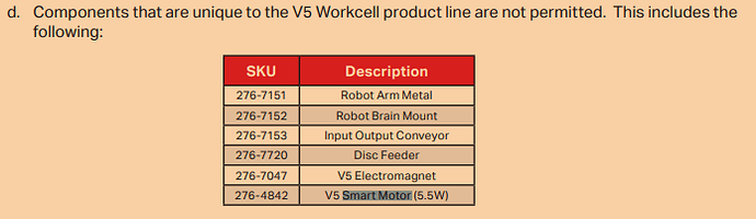

This works, but is not VRC legal because of R6 d
I realized I quoted a rule specific to the v5 workcell, but it is the same part, so the rule still applies.

Original poster is not looking to use in VRC…
So James Pearman’s answer is correct given the use case presented.
