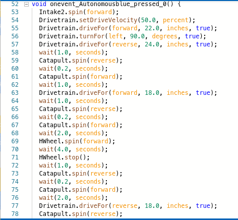

The coder of our team left & now I’m the coder.
I’ve been looking for help to shorten my autonomous code, any ideas?
Sorry if these are silly mistakes!
Try using “spinFor(direction, time, units)” to get rid of “wait(time, units)”
In full, “spinFor(dir, rotation, units, velocity, units_v, waitForCompletion)”
Explore VEXcode V5 API Reference Guide - Learn Coding in Blocks, Python & C++ — VEXcode Documentation
Navigate to IQ (I don’t know if you’re using gen1 or gen2)
