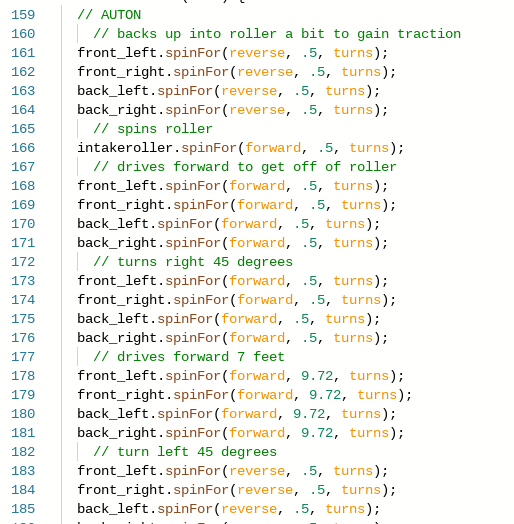

Should I switch to using motor groups? This is my auton right now:
It feels very cluttered but I don’t really know how to use motor groups.
Some insight would help!
I would recommend making a a function to drive the robot given number of turns
you could also try to use the drivetrain function, this makes coding auto so much easier.

Basically you can declare a function and the function will run code inside of it when called. I don’t know how to explain it well so hers an example
void drive(float left, float right)
front_right.spinFor(forward, right, turns);
front_left.spinFor(forward, left, turns);
back_right.spinFor(forward, right, turns);
back_left.spinFor(forward, left, turns);
Inside of auton
drive(.5,.5);
Drives each motor side .5 turns
I can’t because I have an X-Drive.
Can you explain why you can’t. @EcstaticPilot just used your code as the template for the example code.
I’ll try that, thanks!
I just don’t know how to use motor groups.
Here’s how to create one:
motor_group  motorGroupName(motor1, motor2);
And to use it it is just like controlling a motor, for example:
motorGroupName.spinFor(fwd, .5, turns);
Try using drivetrain. It would be much easier.
As I’ve said before to someone else. I cannot use it because I have an X-Drive.
Oh, sorry, didn’t realize that, should’ve remembered to exclude x-drive and mecanum drive.
I say probably not, as it would be easier to do them individually, most likely, though it wouldn’t be quite as convenient. Besides, it works like this, right?
Yeah, it does work. I just wanted to try to clean up my auton. I’m gonna try the functions and test it tomorrow.
