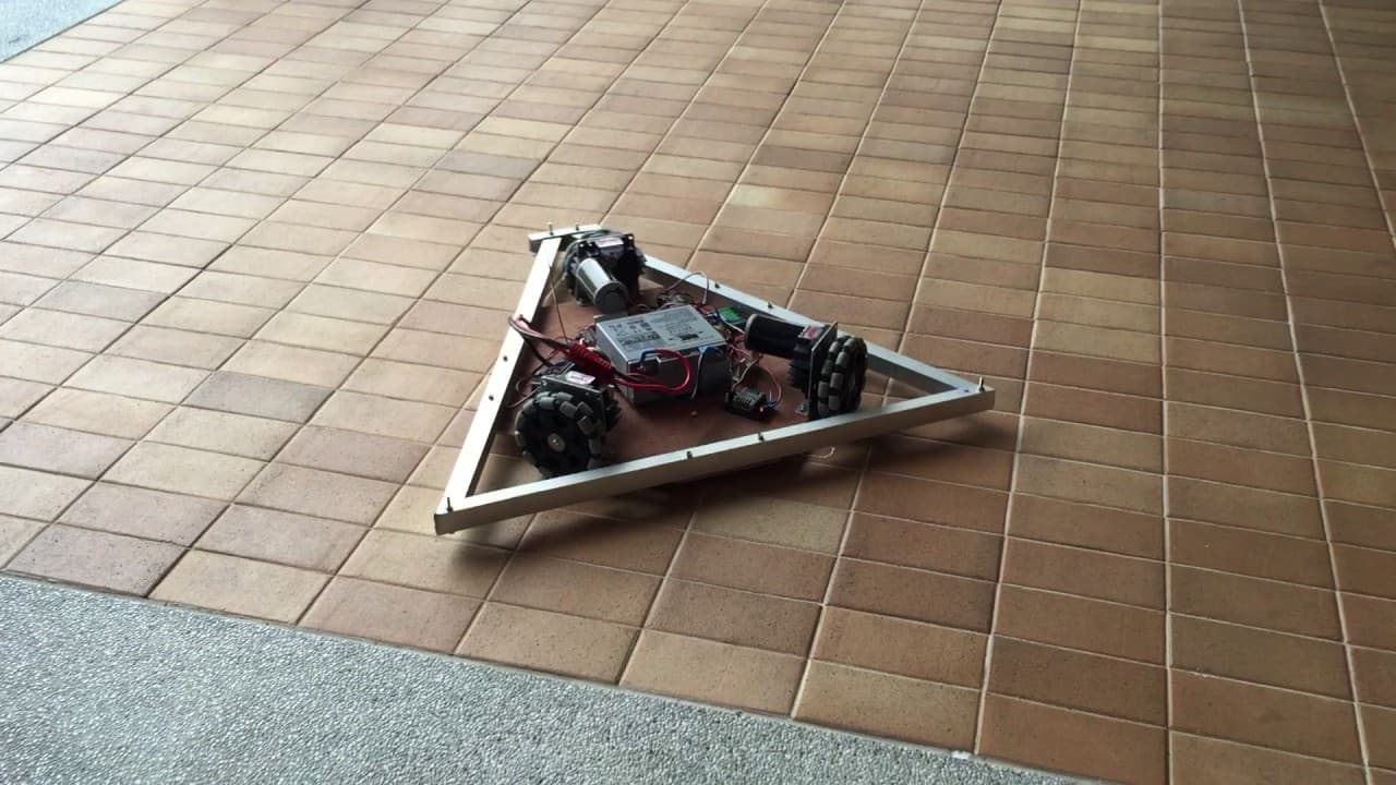

People like running 4 wheels because it distributes the weight more evenly, reducing tile sinkage. However you can still run 3 wheels and be fine.
People like running 4 wheels because this…
is…
disgusting.
There’s nothing inherently wrong with 3 wheels, it’s just easy to push around and thus not the best for competitions. Once you get knocked on your side, it’s over for you.
Just because you see it commonly doesn’t mean it is disgusting. All of those seem like functional, working robots designed for their respective purposes.
Nah thats fantastic
20char
I was joking…
But seriously, although I’m sure it has applications, I think it’s pretty impractical for this year’s competition.
try using maybe 6 wheels total- the 4 outer ones are omni and the 2 inbetween them could be static or whatever theyre called
im using a 3-wheeled drivetrain but I wouldn’t really recommend it for most teams… it’s pretty hard to work with, especially for this year, as trying to work around the pointy end makes things much harder, and there’s limited mounting points because of the angles. I can send you the code i’m using though if that’s helpful.
