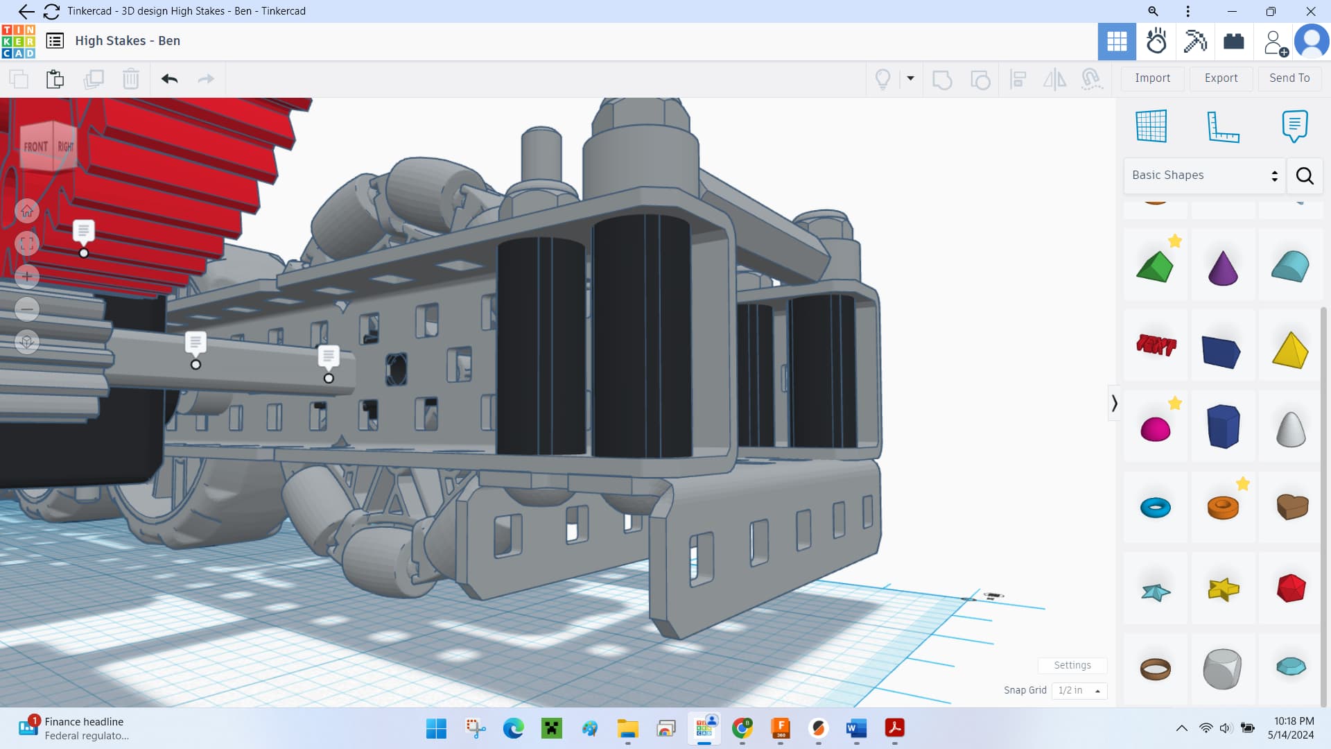

The Robosource 1.5in shoulder screws have a .12in long shoulder. This means that if put a shoulder screw though two pieces of aluminum you have .04 extra sticking out. I was wandering if you could force a 3/8 black Robosource spacer over it. (I have no parts yet and my organizer wants to see a CAD before we order them.)
Well, spacers are a bit “squishy” and malleable, so it would take some force (aka cranking that nylock nut to force the shoulder in), but you definitely can do it (I’ve done it a few times, only a little bit though)
You could probably fit it in if you think you would need it it’s better than nothing
https://youtu.be/yC_6j7vawfk?si=VqMJmhuzJaQekY7H You don’t need shoulder screws on your final robot. You can use shoulder screws to square the drive train and then lock each drive channel in place with bracing attached via normal screws. See 4253b’s video for more information.
