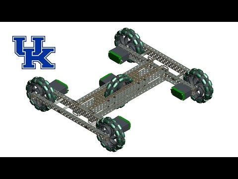

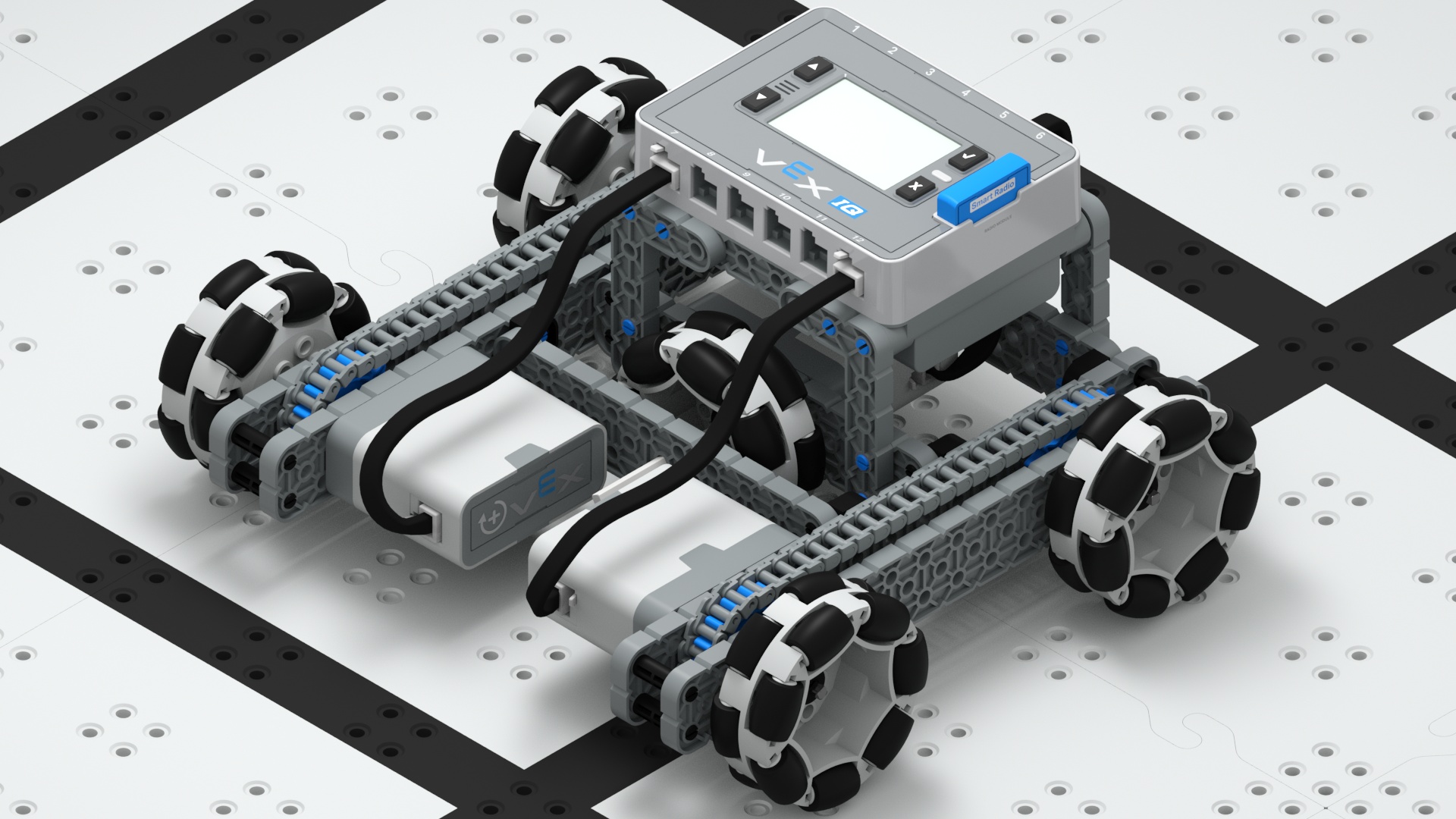

You need to add a wheel in the center, and power it with a motor to move your robot sideways. Try looking up H-Drive for some ideas if you want to design a mechanism similar to this.
Only certain types of drive trains can move sideways. I suggest you look up “H drive” “X drive” and “mecanum drive”
file-MkdCzDcDoX hqdefault
Refer to these images
I would recommend h drive over mecanum or x drive, they can be annoying to code.
