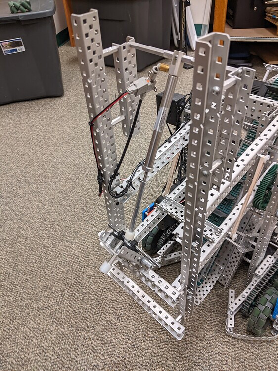

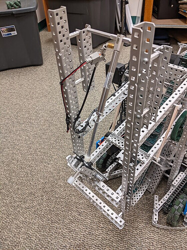

1 motor lift is not a problem on our bot with no pneumatics (4m drive, 1m lift, 1m backlift, 1m claw)

Simple Lift:
2 Motor Lift (Red Motors aka High Torque Motors)
4 Bar Linkage
12t to 84t gear reduction (Motor attached to 12t gear, 4 bar attached to 84t gear)
Claw:
Pnuematic Claw (More Complicated, but very nice for driving in matches, plus leaves you with spare motor
Motorized Claw (Heavier for Lift, but 2 motor high torque with 7:1 gear reduction its fine)
Lots of examples for simple claws online
Motorized Claw: Vex Tipping point new clamp for states - YouTube
Pnuematic Claw:
