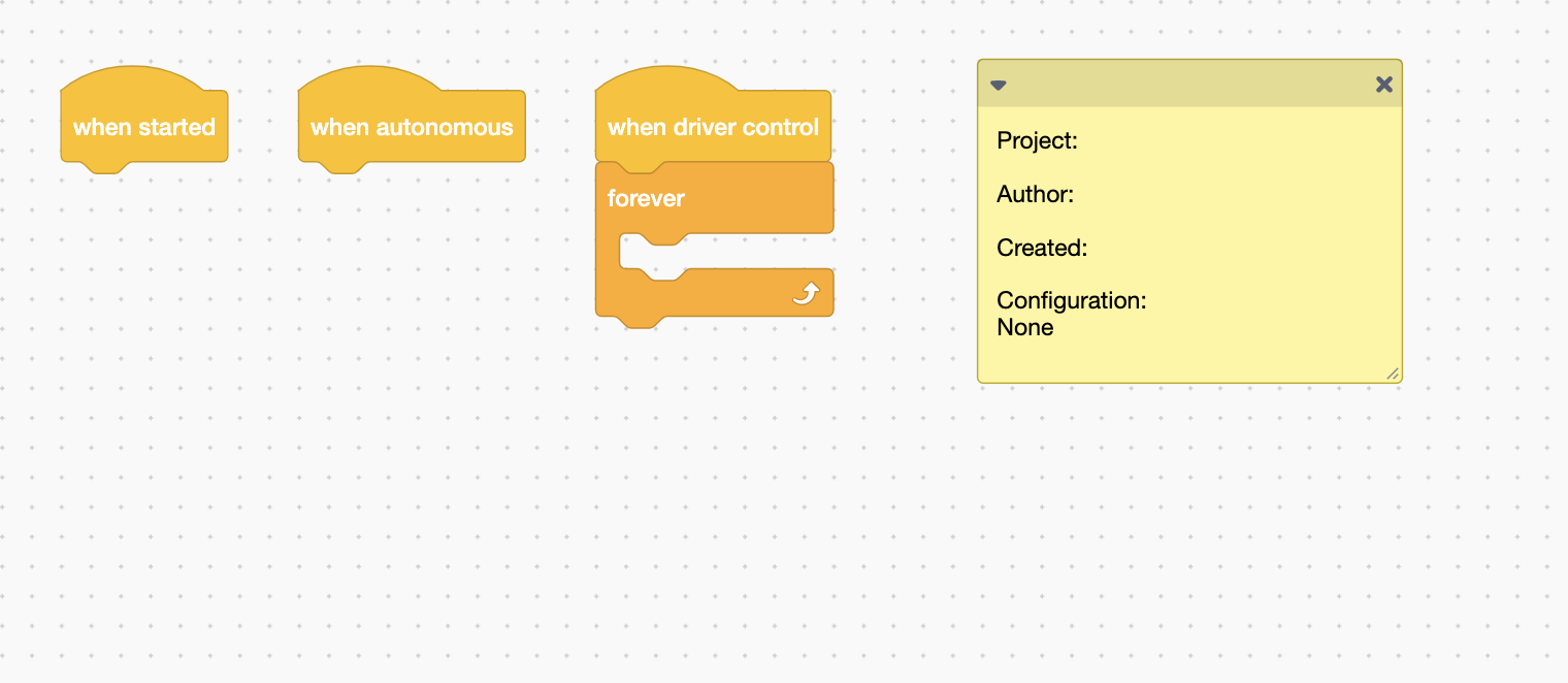

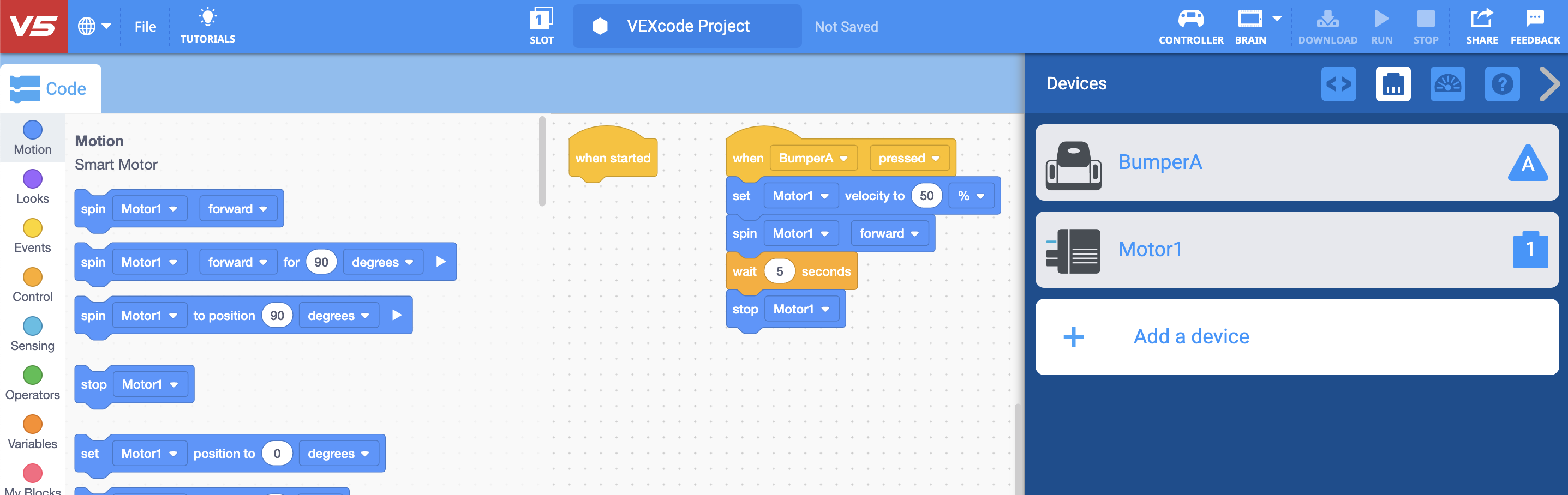

If you’re trying to create “simple” projects, why not use Blocks? It generates the same C++ code as if you were doing it in VEXcode Pro/Text - so there’s no disadvantage in terms of execution speed.

VEXcode’s block interface is 100% competition legal and capable. A number of teams have made it to VEX Worlds programming in block-based coding.
