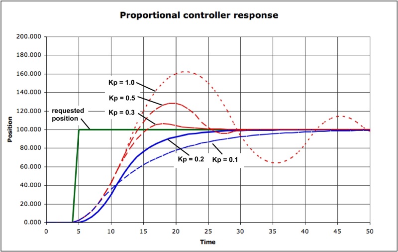

So for the start of a new year I thought I would post some code for a simple (and I mean simple) proportional controller. The question of arm control seems to come up a lot so this can be a thread for posting different techniques of achieving that. This is what we are implementing.
(click for original)
A potentiometer connected to the arm measures position, this can vary between 0 and 4095 but will in practice be a smaller range, in the example code I use 400 to 3000 but you need to determine this by experimentation. A single motor is driving the arm as the example uses a clawbot as it’s basis. The assumption is that positive command values will make the arm raise and the potentiometer values increase, I did not check the example code on an actual clawbot, perhaps I will do this over the weekend. If potentiometer values decrease then remove the pot and attach it the other way around so they do.
Here is the example code in ROBOTC, this code uses one task to run the P controller, the constant Kp will need adjusting depending on the arm weight and the gear ratio. I made no attempt to tune it here, again, perhaps I will test on a clawbot this weekend.

If the arm is carrying a relatively heavy load, wouldn’t the code result in the arm oscillating around pidError = 0?
Several factors will affect oscillation, if the arm is tuned without a load then when the load is added it will tend to fall short of its target with a resulting constant error if raising and perhaps overshoot if falling (due to gravity).
The proportional constant also effects greatly how much overshoot there will be. Here is the response of an idealized system where the motor has a linear acceleration, several different values of Kp are shown. The green trace shows the change in requested position, the various other traces show how the arm moves, with Kp = 1 it does not achieve a stable position (although it may do eventually).
Large values of Kp will cause oscillation, small values give a slow response.

If the weight of the are changes( with or without game pieces) will it change the tuning of the p control? Obviously it depends on the wight if the object and other factors, but in general will it make a difference?
Testing shows Kp needs to be about 0.3.
It will have some effect, when going up the error at rest will be larger, when going down it will have more overshoot (but then again going down only works marginally with this simple controller).
