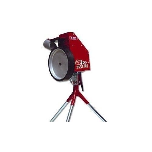

less contact time would be best for a single wheel. problems seem to pop up a lot when the ball has to travel along the flywheel for any distance.
look at a picture of this baseball pitcher.
[ATTACH]9724[/ATTACH]
It only has a plate for the wheel to push the ball against. You also want a good amount of pressure (more than most would guess) with any kind of flywheel shooter. All this should help accuracy, but you will never get 100%. 2 wheel flywheels are normally known for being more accurate for a lot of nitty gritty reason.
