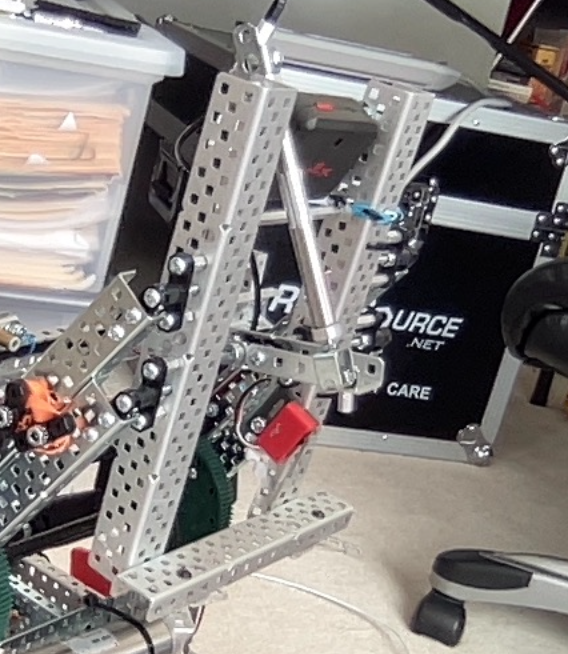

if you want a good claw, here’s one. It has won every single tug-of war it has been in, uses very little air, and is extremely robust and reliable. I still haven’t found one better than this.
it’s a terrible quality picture, but I had to use the computer’s camera.

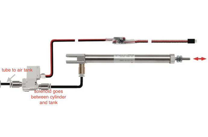

if you mean pneumatics themselves, it is very simple. there are 3 main components:
the air tank
the solenoid
the cylinder
the air tank stores all the compressed air used to run the cylinder. this is like the battery for V5 motors.
the solenoid controls whether the air in the cylinder gets let out, or the air from the tank gets let in.
the cylinder moves by having a part get pushed out by the incoming air. in the case of single acting cylinders, it gets pushed back by springs when the air is let out.
the solenoid is the thing that links the cylinder to the air tank. If I didn’t answer your question well enough, this will explain everything:
https://kb.vex.com/hc/en-us/articles/4404197704212-Getting-Started-with-Pneumatics-with-the-V5-System
you’ll probably have to get a decent air compressor, and searching the forum can help with that; that’s how we got ours.
the tubing is tricky, but the link I sent should help you get that set up.
but, the programming is pretty simple. you just need to create a “digital output” device in Vexcode or Vexcode pro, which ever one you use. this will represent your solenoid. setting the device to true or false will control the solenoid.

I meant the claw mechanism. I know how the pneumatics work already
it is also simple. the c-channel the cylinder is attached to has a standoff on it. when closed, this standoff goes into the dish of the goal and keeps it from falling out of the claw while pressing it against the c-channel below it. the angles below center the goal to the claw.
not sure I explained that well, but I hope it helps. I can’t draw well on the computer, or I would create a diagram.
