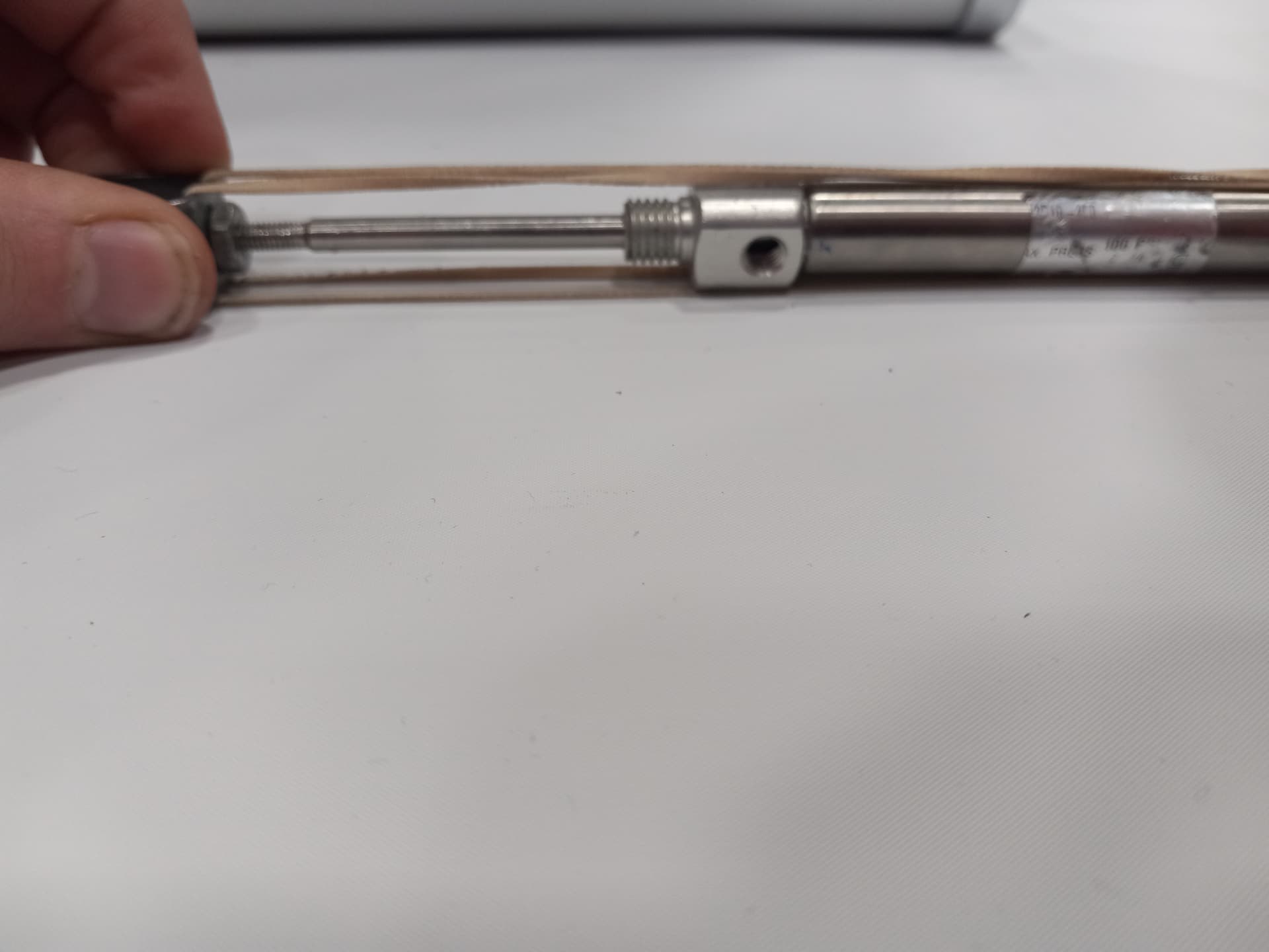

I’m trying to limit my air for my corner clear mech, so I’m wondering how I could make a vex v5 piston single Acting?
You can use rubber bands
use a rubber band like pictured above.
the pneumatic circuit would be similar but plug the solenoid side
