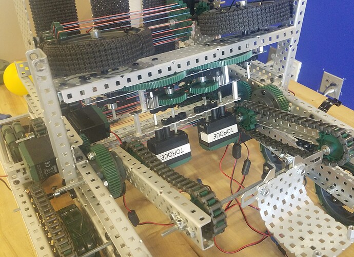

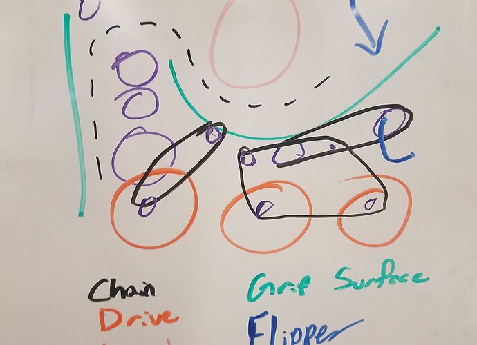

Okay I’ve built most of a robot, shown in the first image, but I have to build a way to hit the mid and high flags. I have this mechanism here but its booty (second image). I’ve decide to build it like in the third image, which is a drawing depicting my chainbar cap flipper, drive system, intake, and what will be my launcher, as well as an index roller for feeding the balls into the launcher. The current design is a two wheel flywheel, but its being changed to a single wheel flywheel. There are 4 drive motors, 2 intake motors (1 intake and 1 index motor), and one motor operating the cap flipper. that means i have used 7 of the 10 motors already, which leaves 3 to power the launcher. My first question is how should i do the gearing to make it most efficient. i want all three motors on one side, the weight of the flipper motor, cortex and battery will balance it out.

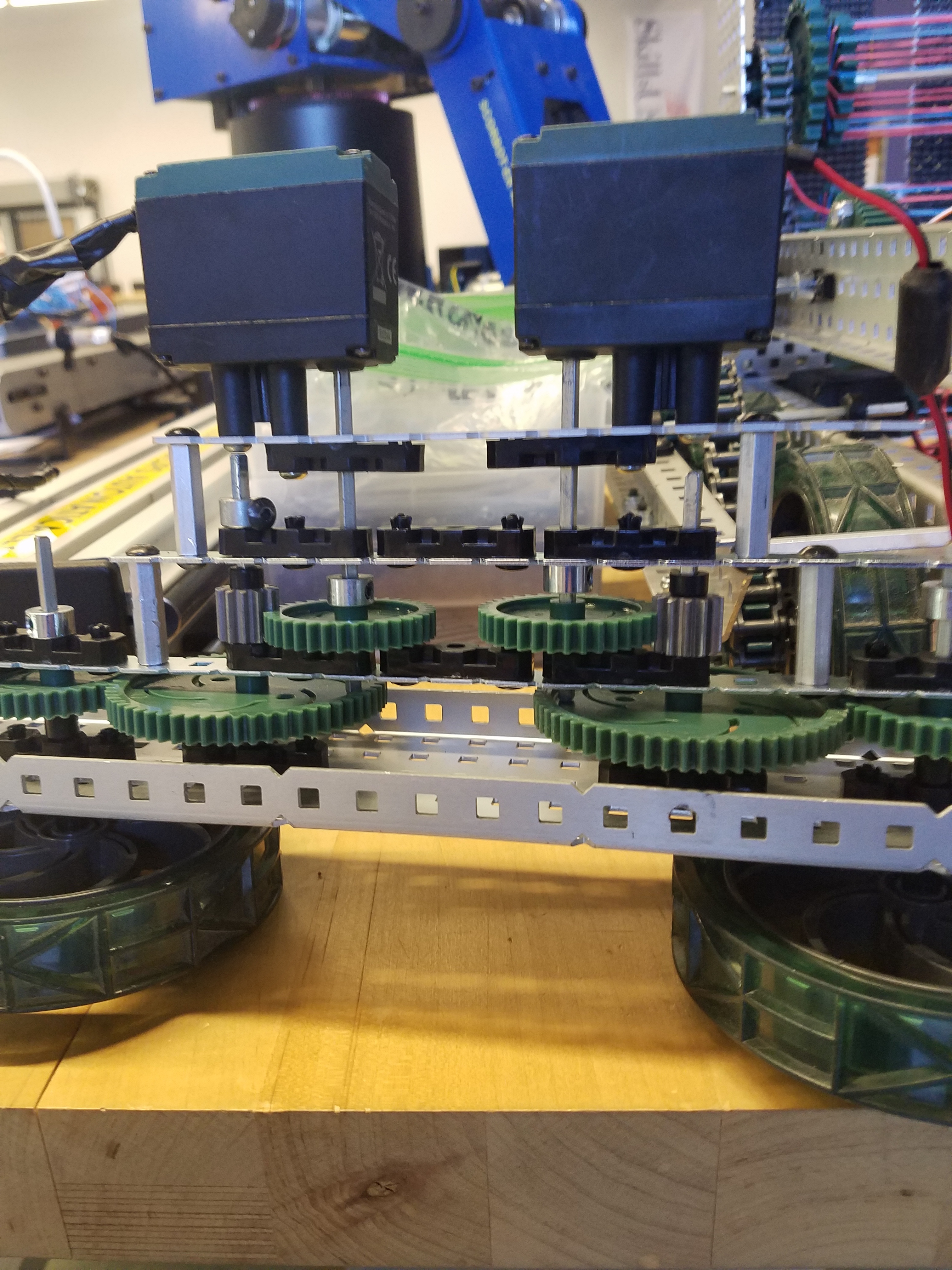

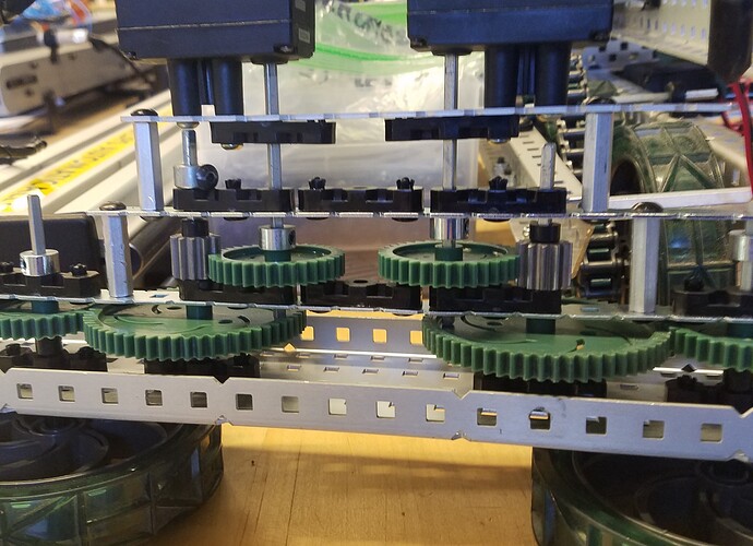

I have all three motors on one side meshed together with 60 toothe gears, and driven from there with a 1:21 gear ratio. Spins at 24.93mph. I have it mapped to run at 0, 20, 40, then 127 using the buttons on the right side of the controller. Manually accelerating and decelerating, going up or down in the sequence. Not as smooth as i would like, but with three motors theres enough redundency that if one goes out im not dead in the water. And i have some frankenmotor donors im bringing to competition, so if i need to hotswap some internal gears i have em.
