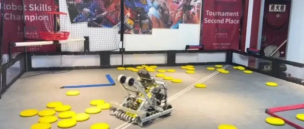

Could you link any videos to these people you’ve seen? Maybe we can all analyze some key differences in performance based on the videos. I’ve only seen one half reveal from China. I hope one is a turret so I can get some vindication that the Chinese approved of the design.
It’s not hard to find them if you know where to look!
Also, let’s try to stay in topic…and no, there’s no turret. I don’t think China would build that complex of a design when driver practice could achieve practically the same functionality.
This is one of the better ones that I’ve seen from China. They also provide a detailed explanation of the advantages of each flywheel type underneath the video.
Yeah man, I’m usually on the forums/YouTube I don’t tend to go looking into the mp.weixin.qq sites cuz they’re sketchy (at least to my western brain, I don’t really know much about how the CCP mines data). Plus it’s super hard to use the internet because I have the slowest WiFi on planet earth, but I did find it on yt and was able to watch: VEX Robotics Spin Up | Team13186A | Double Flywheel Shooter - YouTube
From our testing of flywheels, two motor one flywheel shooters shoot insanely far, surpassing twice the length of the field at something like 20 degrees, which isn’t even the optimal range. One motor one flywheels can do maybe 3/4 across the field, with less reliability.
According to them, they’re doing double flywheel quite literally because it’s weaker, giving them more disc capacity in the goals (discs aren’t flying off into the sunset). This is definitely a smart idea. However they have to be EXTREMELY close to the goal to be able to shoot, and have almost no stability. This could be just them, I’m not able to watch much more right now (it takes ten minutes to watch a one minute video, - looking for it). If it’s not though, I will say full heartedly this is a horrible idea. Yes, this is ok for driver skills, maybe even better, however with a head to head match, i think range will be key. I do like the idea of extra disc capacity, but you could just have to seperate buttons for shooting: one for a long range shot, one for a short range, and then use two motor single flywheel
