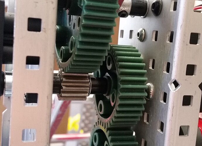

We’ve come across an issue that I’ve never encountered before.
We have a 12T gear powering a 60T gear on our lift, and for some reason, they don’t mesh together properly.
Because of this, when the mechanism has too much resistance, it skips.
We tried doubling up the high strength gears, but that doesn’t help because they’re still too far apart
When we push up on the 12T gear, it’s movable a noticeable amount upward.
The only thing that I can think to do is to completely rebuild the lift with a 12T gear on both sides of the 60T gear, but that would mess up our scoring mechanism.
Does anyone know of anyone know of any other solutions to this problem?

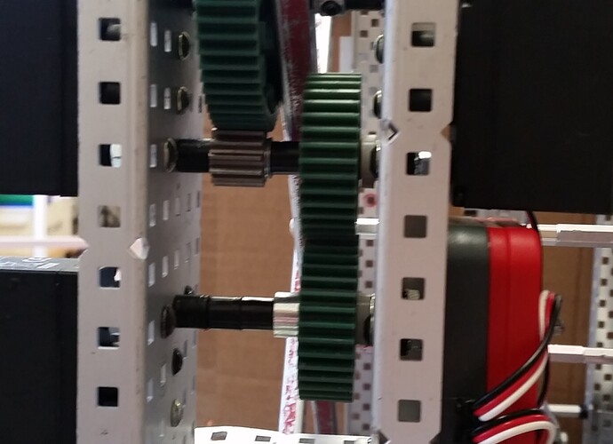

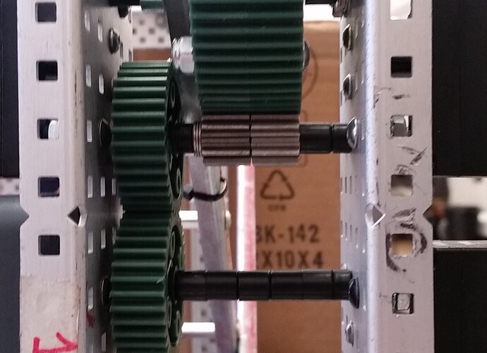

Here are the pictures.
Nothing real obvious…but probably flex in the shafts combined with slop in the bearing mounts. Move all the flat bearings to the inside (will shorten the shaft lengths reducing flex), use screws and nylocks instead of Keps nuts to ensure they stay tight. Use a High strength shaft for the large gear. Last resort-back up the 12-tooth gear with a free-spinning idler gear on the right-hand side shaft.

Sandwich your 60T gear with another 12T on top of it as an idle. This should keep the gears from flexing away from each other.
While @yoneshige 's solution might mean you have to move your dumper down a hole or two, I think it’s probably one of the most effective ways to keep your gears turning. We experienced that with our v1 dumpapult design; we originally had 6 motors all at the bottom turning an 84 tooth gear at the top of the gear train, but experienced slight problems with twisting/bending; moving two motors to be above the 84 tooth gear and thus “support” it on both sides fixed the problem.
