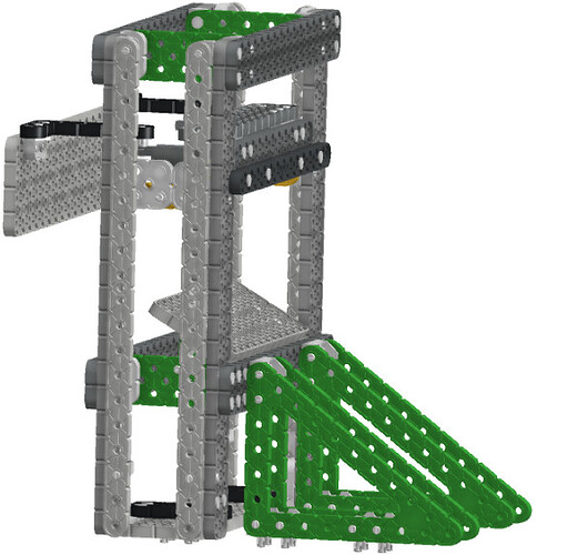

On a whim tonight while I was perusing the game manual to see if anything indicated the starting position of the purple dispenser (didn’t find anything in the 0.1 version), I noticed this discrepancy in the yellow dispenser and the angle of the ramp.
Field assembly manual (step 43/page 90, retrieved today 5/19/22):
Note the ramp leads down to the same side as the triangular braces.
Game manual (v0.1):
Note the ramp is oriented to the same side as you would go to press the drawer to release the pucks.
Now, I’m assuming the field manual is the correct orientation, and the game manual should be updated to match. I’ve not seen any other notable discrepancies on the dispensers between the manuals. It’s an interesting hint that the ramp must have originally been the other direction, but that would have made it much easier to drive a bot straight up to it and have it go straight into a collection mechanism; turning it around to the other side makes that a much more difficult task to achieve (unless the field assembly instructions are actually in the wrong, but by now, I’m guessing it’s the right way no matter what :smiley: ).
Not sure if there’s a better sub-topic for this to get put into, or a certain person to tag (@Sidoti ?) to see if the right image can make it into the v1.0 game manual update.

Good catch. The reveal video also shows pucks opposite of the button.
Cheers.
I would agree. The field CAD aligns with the build instructions, as well:
Yes, the game manual render seems to be incorrect.
The ramp should be oriented such that the discs exit from the opposite side of the green 4x16 trigger plate.
My other favorite thing about the manual version is that the pucks are levitating, with the trigger plate pushed in like it is. :joy:
Thanks for confirming!
