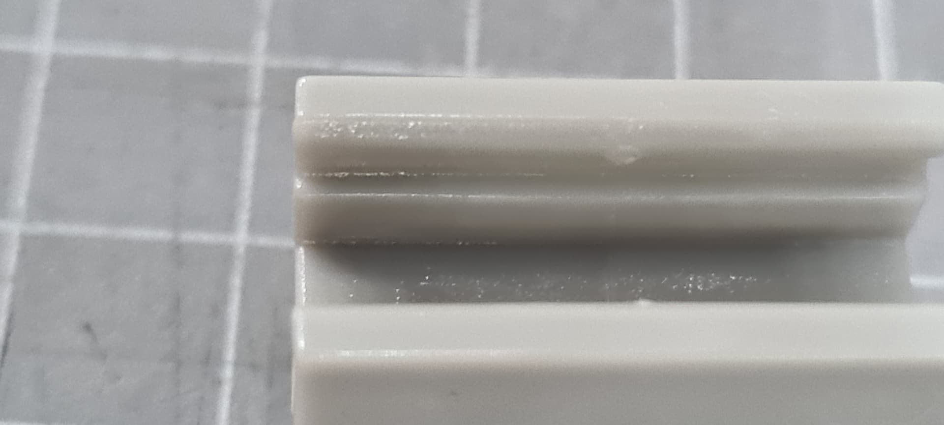

Thought i would post up for anyone else that has issues with the yellow dispenser jamming up when you try to empty.
We found that the holders for the linier sliders has burrs where there is a seam from the manufacturing process.
We removed the burrs and have not had a jam up with the dispenser since.
When your kids go to competitions they will not have this modification. This may impact their programming. While it’s not ideal, I’m very hesitant to make any changes to the fields as that’s not what they will experience outside your room. VEX IQ pieces should not be modified outside of metal shafts.
I do wish this was done to all kits before before they were shipped! They can be a pain.

Just a thought, but perhaps the jamming yellow dispenser issue needs to be addressed more formally. In our tournament today, we had the yellow dispenser jam four times on three different fields. We’ve not seen this problem before, either on our practice field or during a prior tournament. In one instance, our robot hit the push bar hard four times - nada. Understood about modifying parts but truly, there may be a QC issue here.
I raised it with the game committee and the answer is.
Thank you for your question. If you believe the linear slider or any other part of a game element is defective, please contact VEX Support to have it replaced. Modifying a part should be done only as a last resort.
https://www.robotevents.com/VIQC/2022-2023/QA/1241
You need to press it in the middle and push it straight back. It’s wishful thinking that you can push it anywhere on the green bar.
Agree! Wishful indeed! That’s my point. If, indeed, it is the burrs referenced above that are the cause, perhaps a formal directive could be made that tournament officials check for any such burrs and remove them. We had not run in to this issue until yesterday, suggesting perhaps some inconsistency in manufacture? Maybe a QC issue?
