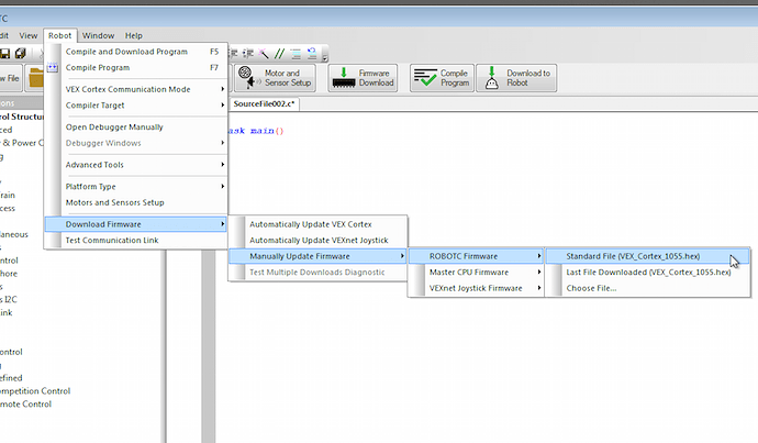

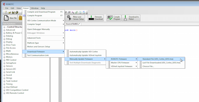

Make sure both the master and user firmware are downloaded to the cortex, this has to be done manually since RobotC flashes it’s kernel separately unlike PROS which builds and flashes user code and kernel together
Otherwise its either an issue with RobotC or (probably) master firmware
If it tells you master firmware is already up to date you can forcefully re download by holding the config button and turning on and off the cortex to put it into bootloader mode

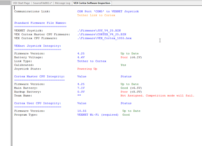

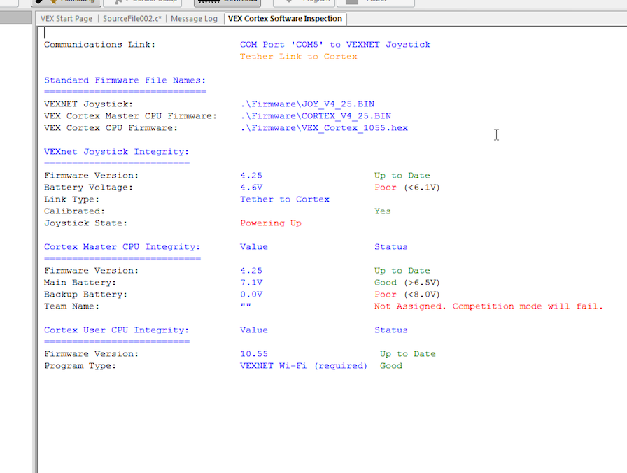

PROS will overwrite the RobotC firmware so after using it you have to download the RC firmware again. There should be no need to update the master firmware or anything like that.
You can check that all is good by performing a software inspection afterwards.
