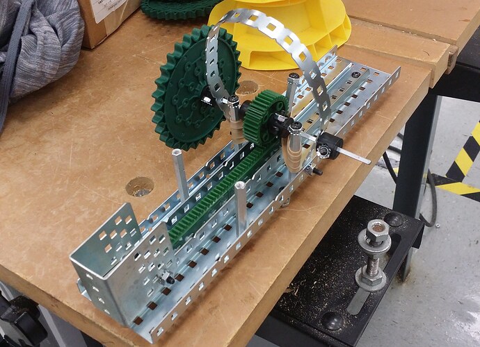

So after hearing about slipgear punchers, I decided to quickly whip one up. As you can see in the pics, it does what it needs to do but the recoil heavily warps the c channel when it slams the standoffs I placed in the back
What kind of bumpstop should I be using?

I think I’ve seen some people use nylon rope that is tied off to a fixed point to stop the puncher at a certain point. The streching of the rope expends energy over a larger period of time, so the deceleration isn’t as harsh as the approach you are currently taking.
Some people also use rubber intake wheels as mechanical stoppers.
#3
Key thing when doing a puncher is to match the mass of the plunger to the mass of the punched object.
If you design the mechanism in a way that the plunger is free to accelerate, then only hit the object at the end (instead of rolling it the whole time, that would be more of a catapult), and if you match the massses, you’ll get great energy transfer (think billiards) and the puncher won’t slam the stop.
You still need a stop in case of mis-fire though, but that could be elastic.
Such a puncher worked great for the VexIQ BankShot, so I expect it to work well for similar Turning Point balls.

@Alex241N That was pretty good. If I can find some time later this week I’ll correct a few things. Some of the points that are off are small, some not so small. I’ll quickly summarize the for now:
  1. You do not want to strike at maximum kinetic energy like this. This is because the collision is not truly instantaneous. You want to strike a very short distance before maximum kinetic energy would have been achieved so that you’re at nearly maximum speed and are still pushing through the collision. This is akin to why people in sports are taught to keep pushing through a collision. I did a calculation a while back about following through with a sword swing or not; letting go at the moment of impact results in a loss of about 25% of the damage that can be done (very rough as damage isn’t clearly defined by the weapon and because different swords are built differently). Fortunately, the collision will probably happen over a short enough distance the this won’t matter much.
  2. While you stated correctly that this is an inelastic collision, you did not calculate for a general inelastic collision. You calculated for a perfectly inelastic collision, which means you’re saying the puncher and the ball stick together after the collision. The reason it’s called “perfectly inelastic” is because this results in a maximum loss of kinetic energy to deformation and the like. This works very well for such collisions if you’re looking at the moment of maximum compression, but it doesn’t work so well in evaluating the collisions overall. This is why @nenik gave the recommendation of matching the masses. @nenik was assuming an elastic collision, in which case you get a perfect transfer when the masses are the same, entirely stopping the puncher. I’m not sure how elastic the collisions will be, but steel or aluminum striking a relatively rigid plastic ball will be fairly elastic, a lot more so than striking a foam ball. Still, we’d be better off assuming a general inelastic collision and running a few trials to see just how inelastic the collision really is.
  3. Not wrong, but accidentally deceptive. The way you’re showing what to minimize or maximize to prevent damage makes it look like you want decrease the distance over which the puncher stops. You really need to address this a little differently. You’ll note you seem to contradict yourself later: are you trying to minimize force or work?
  4. Decreasing mass does not decrease how effectively you launch the ball. It will past a certain point, but it will increase how effectively you launch until that point. If the puncher has too much mass, it will retain too much kinetic energy in the collision. If the puncher has too little mass, it will rebound backward and also retain too much kinetic energy in the collision. You want to find the sweet spot.

You’re contradicting yourself. First you say your calculations require no deformation. Then you go a calculation for perfectly inelastic collisions, which assumes maximum energy loss to deformation and the like.
Yes, look at force. What you wrote is even confusing you. No, you do not want to minimize the (Distance * (1/Time)). You want to increase both the distance and the time over which it stops.
No, it doesn’t. You have two really big errors here along with a smaller one at the end. I’ll address the two major ones separately first. I’m going to ignore the duration of the collision itself for simplicity here. I’m using these variables:

I did the calculations, though I’ll have to write everything up cleaner later. If the collision conserves the fraction f of the original kinetic energy, then the ideal mass of the puncher for the collision is
M=fm,
where M is the puncher’s mass and m is the ball’s mass. This may not be the true overall ideal mass for the puncher because in making it light enough maybe it won’t slide as well, hit the ball as straight, etc. But whatever your design, you want to try to get the puncher’s mass a little below the ball’s mass if it doesn’t mess up the rest of the launch mechanism, at least assuming you want the puncher to mostly stop on its own and get efficient use out of the elastics. What will be confusing is f itself. That fraction f depends on a lot of things, including the masses involved, the specific materials and their shapes, and the speeds at impact. Consider throwing a bouncy ball at a window: slowly gives something reasonably elastic, while quickly breaks the window and is far from elastic. Consider Earth plowing through a tiny bit of debris in space, f will be nearly 1 even if the collision is perfectly inelastic. To start I would assume f is less than 1 but fairly close to 1.
So, targeting a mass just a little less than 55 g with steel, aluminum, and plastic? I just put a single rack piece and a single steel gearbox bracket together on a scale. They came out close to 60 g. That’s a fair amount of steel, too, though there were no screws included. So it should be possible to get the mass of the puncher at least in the vicinity of the mass of a ball.
Putting this together, my recommendations for building a slip gear puncher would be:
  1. Design it without worrying much about the mass.
  2. Once you have a good design, try to reduce the puncher’s mass toward a ballpark 50 g without messing up your design.
  3. After you see how much follow through the puncher has, deal with your stoppers to get things in the right place without damaging the stoppers.
