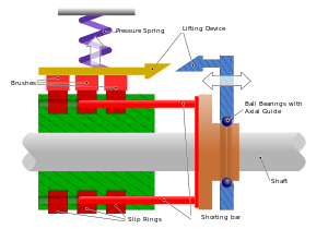

Has anyone thought about using slip rings to allow unlimited rotating on launchers?

You just can’t do it. You have to connect all VEX motors with VEX wire. The only electrical stuff we’re allowed to mess with is for sensors. And in no way can a spinning turret with a cannon on it be considered a sensor.
A slip ring is an electromechanical device that allows the transmission of power and electrical signals from a stationary to a rotating structure. A slip ring can be used in any electromechanical system that requires rotation while transmitting power or signals. It can improve mechanical performance, simplify system operation and eliminate damage-prone wires dangling from movable joints.

[ATTACH]9350[/ATTACH]
here are some rules I would be worried about breaking.

You are not allowed to modify wires in VRC. Not to mention, you’d have to be careful with the safety issues of having exposed wire leads. In VEX U, you are allowed to use other sensors and electronics, but those sensors and electronics are not allowed to directly electrically interface with motors. Therefore, a slip ring would only be legal in VEX U for sensors or other electronics.
