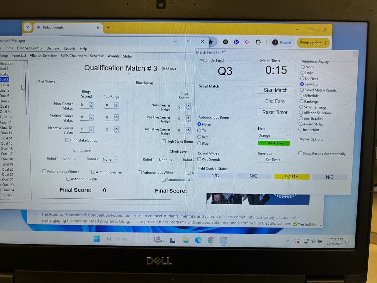

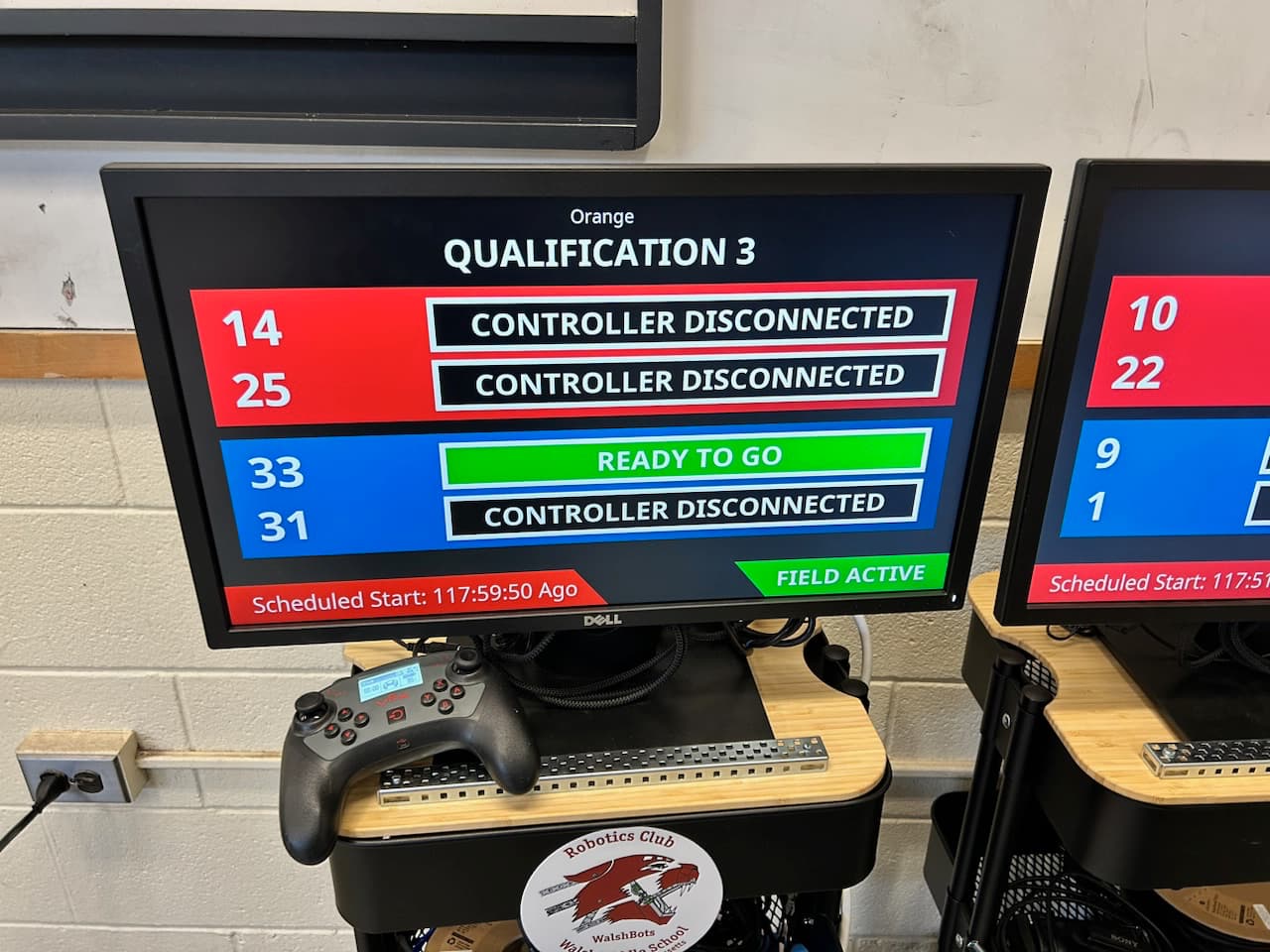

The raspberry pi does show a valid IP on the screen and in tournament manager. In fact the raspberry pi works perfectly for everything that I want it to do. The problem is that the field controller is not showing up red on the match control screen. It should show that there are no controllers connected. But it is just blank.

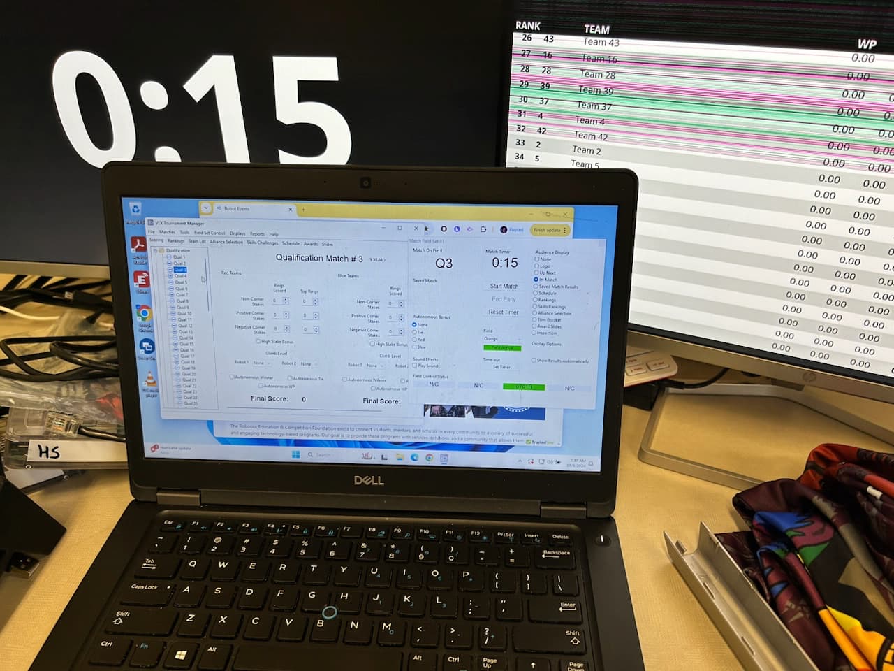

I have operational setup in my classroom, will do some checks to see what is displayed in TM… My attention from earlier test were diverted to broken monitor :frowning:
Tested this morning - I did have an issue with the Match Control panel on TM not synced with TM after laptop was asleep over night and all rPi repowered . I closed the Match Control panel and reopened for the field set and everything works as it should.

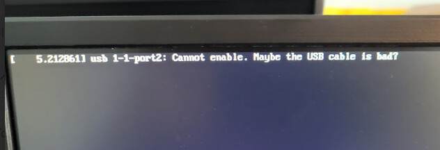

Here was the real problem. I checked my Micro USB cable by plugging it in from my laptop to the Field controller. It saw the field controller and when I started tournament manager, it wanted to add it to a field. It was showing a standby/Active field and I assumed it was a good cable.
However, … when my raspberry pi starts, for just a quarter of a second it displays this:
It’s hard to see because it goes away so quick, had to take a picture to see what it was saying. Don’t ignore this message! Because no matter what USB port on my Pi I use, this cable which works fine on my laptop, does not work with the Pi.
