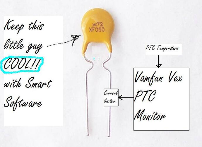

Smart software monitor keeps PTC fuses from tripping
https://vexforum.com/attachment.php?attachmentid=6676&stc=1&d=1345278398
This blog post contains a video link to my latest testing with two 393 motors in my Trophy robot and V1.0 RobotC smart PTC monitor software.
So far so good!!
No need to look at the jpg…it is the same as the embedded image.
smart_PTC_monitor beta code release
Download: https://dl.dropbox.com/u/17455717/smart_PTC_monitor_template.beta.8.27.12.c
[edit…please redownload if you grabbed the code before 1:45pm 8/31, I had some critical stuff commented out before then]
Ok, I’ve got the RobotC code used in my smart_PTC_monitor developed to a point where I would let others play with it. I originally used a single timed iterative loop that ran in the same task as autonomous and user modes. I decided to create a separate task that simplifies the user interface so normal programming can occur without any of my constraints. When done, the user functions are easily inserted into my template to seamlessly add the PTC monitor protection capability. The program is self documented with liberal commenting but I am sure people will have a lot of questions. I am putting it out without fully testing all the possible motor configurations to get early user feedback and if it proves to have utility, I will put out a more mature version that includes user feedback.
Please post your comments to the Vex forum thread where the program is introduced. Thanks
