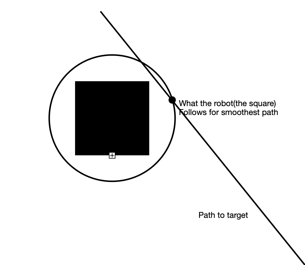

Even though the fastest path from point A to point B is a straight line, depending on the robot’s heading, traveling in a certain arc at the beginning is the fastest. You can make this work by drawing an imaginary circle around the robot and a line from the robot’s starting position to the desired position, and following where the lines intersect, but I don’t know how to do that. If I’m using a standard tank drive, how do I accomplish this task?
You’ll want to research “Trajectory Generation” (often in the context of “Motion Profiling”). For example: GitHub - JaciBrunning/Pathfinder: Cross-Platform, Multi-Use Motion Profiling and Trajectory Generation . This basically looks like a “constraint” problem (how to I get my robot from Pose A to Pose B in the shortest amount of time, given velocity, acceleration, etc. restrictions)
Other relevant searches might be “Pure Pursuit”. This is the first in a series of videos that does a reasonable job walking thru an implementation of Pure Pursuit: FTC Programming: Pure Pursuit Tutorial 1 - YouTube

okay, but how do I do that using math for programming? also, if I need odometry, how do I do that?
Unfortunately, trignomotry is a must for implementing odometry and pure pursuit, even some move to reference pose/point algorithms. I would recommend looking into that first.
