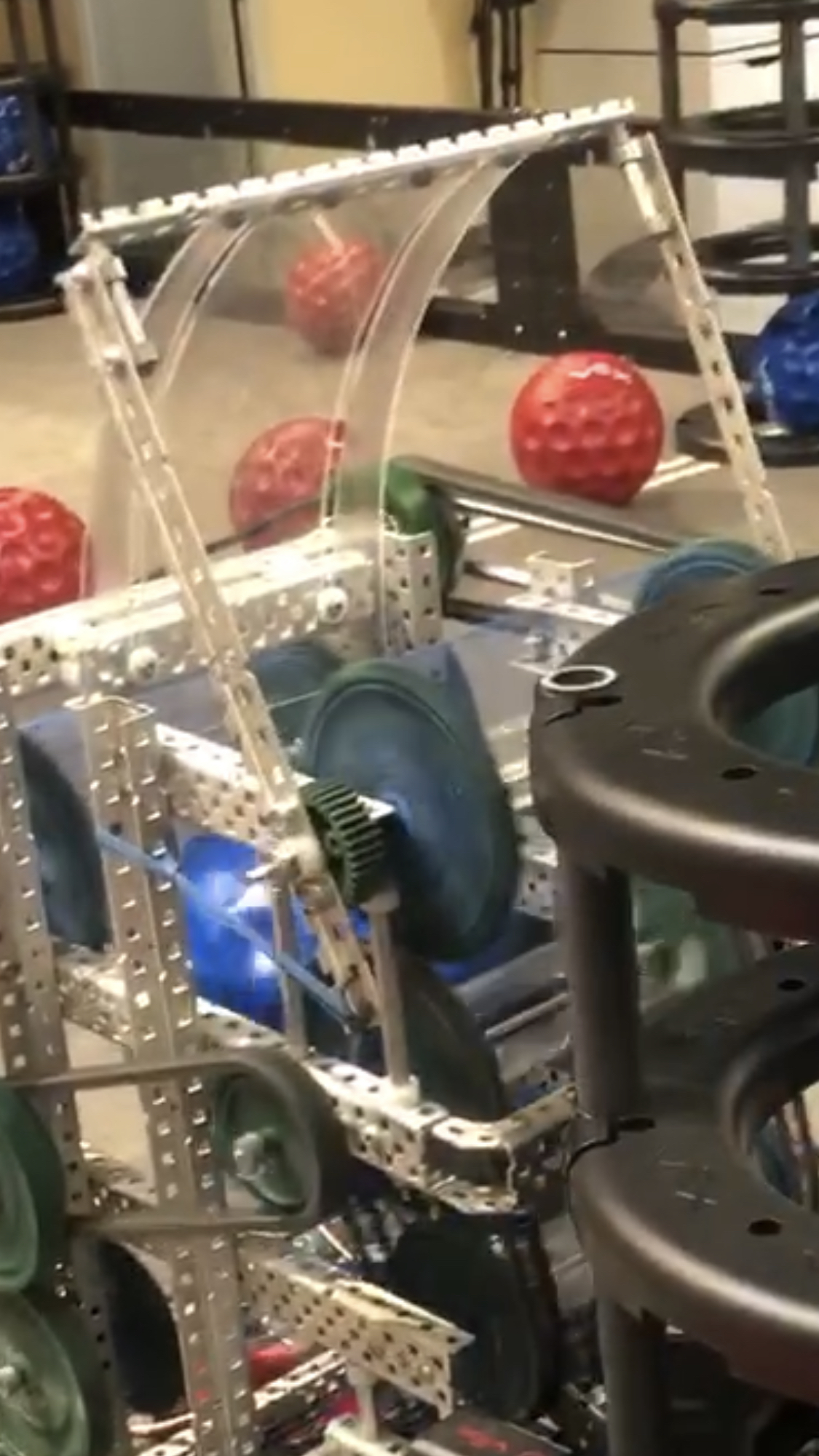

My team made slits in the Lexan and used the thin spacers with screws going through them to prevent the hood from coming out. At the start of the match, the Lexan is flat and then when a ball comes up it gets pulled up by the bands and stays up. Not the easiest mounting system but is very clean.
IMG_91BDCF9104F1-1 2
@neera That’s a really interesting mechanism. How do you keep the Lexan from just going around the spacers? Wouldnt the outside parts be pretty loose? or are they in tension?

The slits are cut just a bit wider than the width of the screw diameter which is significantly less than the rim of the spacer, so even though it’s being pulled forwards its doesn’t come out. The outside not as loose as you would think and hasn’t popped out since its all apart of one piece of lexan. As long as the spacers are screwed in the right amount it should be fine.

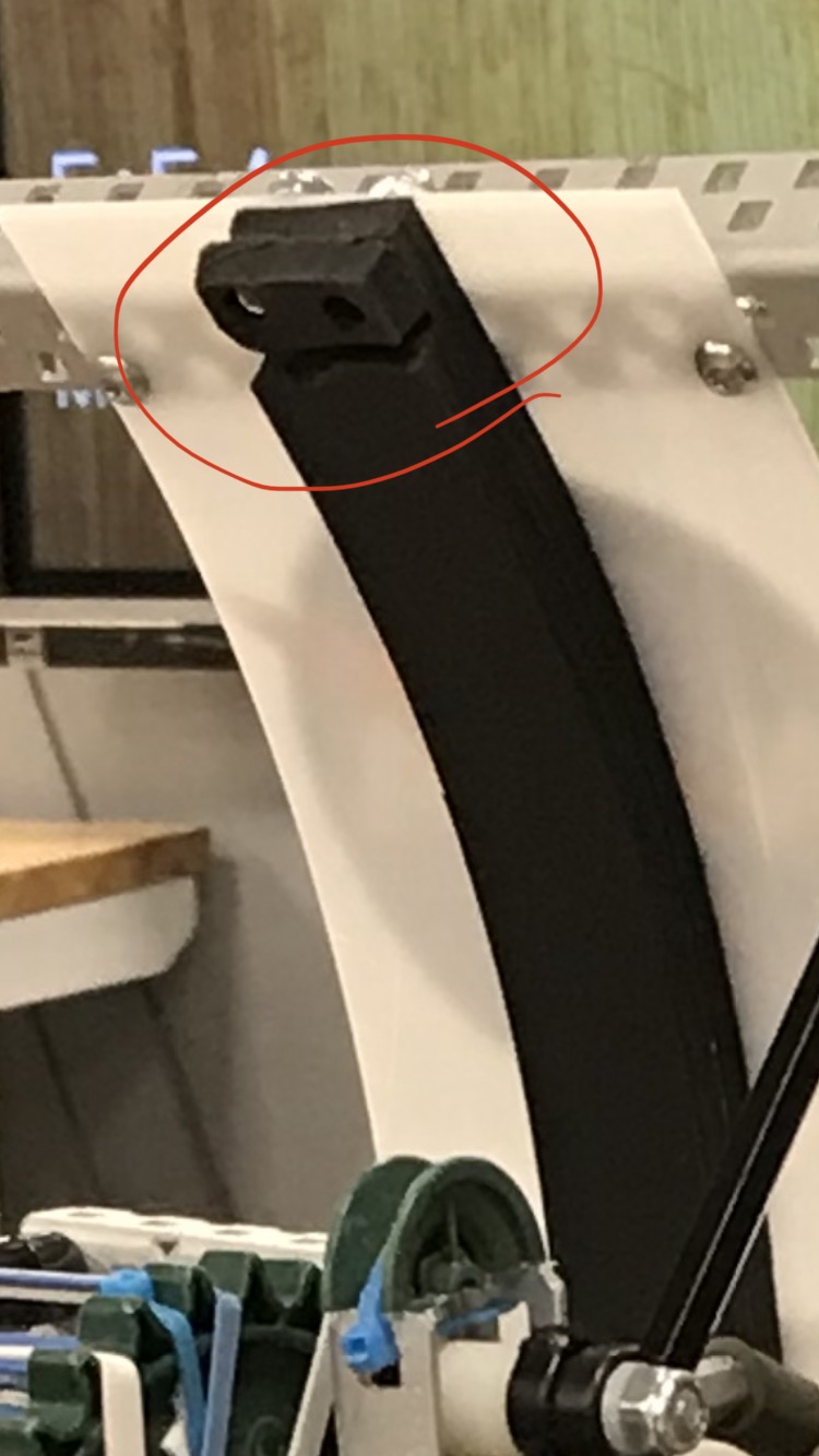

I use a different way of deploying the hood, but the same concept still applies: I have a “hook” on the front of my hood that rests on one of the rubber bands on my middle roller.
Hood “hook:”
(Kinda jank but it works)

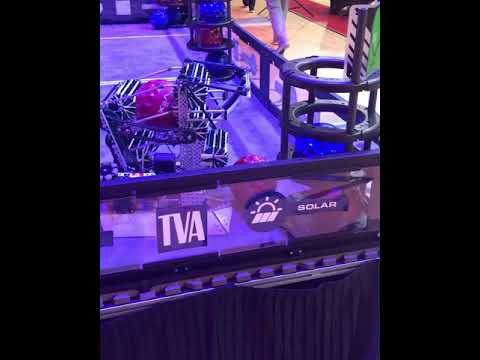

Ours is pretty simple. The way we banded our hood allows it to rest on the top roller when the zip ties we use as stops are tucked next to the top roller. When the top roller spins, the zip ties pop out and the hood is tensioned upwards. This also pushes the backboard up. We’ve changed the backboard since we recorded this, but the same concept applies.
https://linksharing.samsungcloud.com/9U4a40AIIig4
(Driver controlled so not as fast as a macro)
that’s not jank, it’s one of the better ways to do it :slightly_smiling_face:
