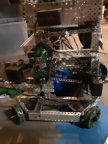

So I am having trouble with my hoodbot, it isn’t shooting the ball out like it was. I think that the problem is that we had a 4 inch wheel tank drive, then we switched to a 3.25 wheel x-drive. this means that our top roller was moved down, but less than half an inch. Before, it was scoring consistently in all the goals, but now it isn’t shooting them up consistently. here is a video and some picture. (upload://23nukbwlgE8WS6N6SDpejYcwiGe.jpeg)
The middle rollers run at 600 rpm, the top one on 1400 rpm. All of them are on 30 tooth sprockets.
I believe it should work-the rollers are at a high speed, there is good compression on the hood. Like I said, it was working fine before, but I don’t think that moving it down half an inch should make such a big deal.
The goal is the middle goal. Since I took it home, I only grabbed the middle goal, and I just moved the front bars up. that is not stopping the ball, I am sure of that. The intakes and the hood also pop out.

your bot looks pretty floppy if I’m being honest. lots of cantilevering, and using really weak parts like plates and bars for structural support. this is probably the biggest cause of any inconsistencies you are having.
your flat hood is probably taking a lot of energy out of your balls as well, I would experiment with a curved one instead.
there’s no easy fix for bad/inconsistent shots, you have to fiddle with roller and hood geometry until you get it right.

Not really, I used the plates instead of 5-wide because I didn’t have any 5 wides. It is plenty sturdy. It was very consistent before I moved the wheel size down. The bars are just left over from when we had a slow tread lift (early season) and the balls were falling out the side. The plates are just there to keep the top connected. The robot is very sturdy, I promise. I have experimented with a curved hood of plate, just as an experiment. I think that it is hard to do a good curved hood like that without back rollers as well. I think that the easiest solution for this is to move the top roller up a hole.

I can tell by looking at it that your bot is not going to be as sturdy as you want it. you’re using angles for support towers, and plates for structural components. it might not be super floppy, but using c channels is probably a change you should consider.

angles are able to twist a lot more easily than c channels, which is the main reason c channels are much more rigid.

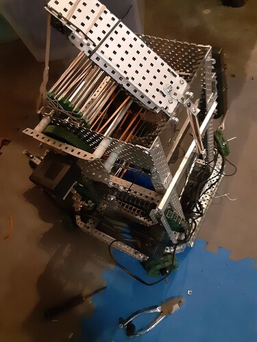

Never mind that, I solved it. I decided to revisit my curved hood prototype, and this time, it worked. It has around 80 percent accuracy, so It can be improved, but here is a video.
Oh yes, definitely. That is just a test. It doesn’t even flip out yet.

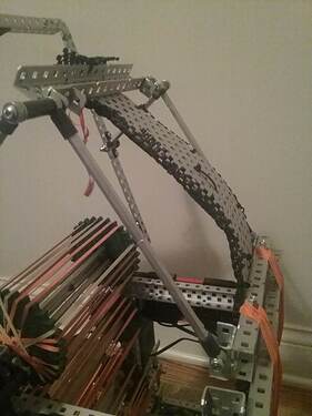

Not the same person you’re asking, but how my team did it was we put standoffs running from the base of the flip-out part of the hood to the end of the hood. These were attached to 2-wide c-channels on either end.
Edit: Added images of my team’s bracing.
The standoffs on the right are the braces. You can ignore the standoffs on the left, they were used to connect to our backboard.
I recommend you can make the hood flip out by putting it under the flywheel rubber bands so when the flywheel spins, the hood flips up. In terms of bracing, you can have rubber bands pulling the hood back and the hood stopping at a certain point. I can post a picture of my hood later.
