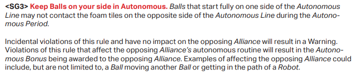

Da Rules
It says here that balls can’t touch your opponents foam tiles, so if you make it in the goal is it good?
nope. You would be interfering with your opponent’s autonomous, which is illegal.
This is in fact illegal as per <SG2> and <SG7>

Well technically, if op were to shoot the balls on the auton line, since those are excluded from the no crossing rule, wouldn’t it be legal?
I had this similar idea earlier but I thought the “sketchiness” of it was too much of a risk.
While the balls that start on the Auton Line are exempt from rule SG3, shooting them into your opponent’s goal during the auton period would still be illegal.CaptureSG2 states that a robot may not contact an opponent’s Home Zone goal during the Auton period.Capture1 SG7 says that you cannot use balls to do illegal actions. This means that you cannot shoot a ball into your opponent’s goal during auton because it would be illegal for your robot to touch the goal, and balls cannot be used to do illegal actions.
