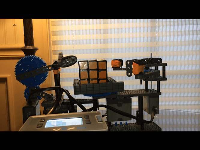

I built my own a while back
Not a great picture, but it shows the general movement mechanisms. Took forever to do anything.
We have 2 vision sensors, that’s the one thing we dont have to worry about
And yet the post above yours shows it in action?
Oh, It does CFOP? That’s nice. Sorry, I can’t tell anything from the thumbnail.
But wait a sec…It says “The cube is solved optimally(about 24 moves)” and average full CFOP takes 55 moves. So it must use a different method.
So it’s smarter than people? My point was it’s working.
